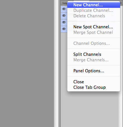

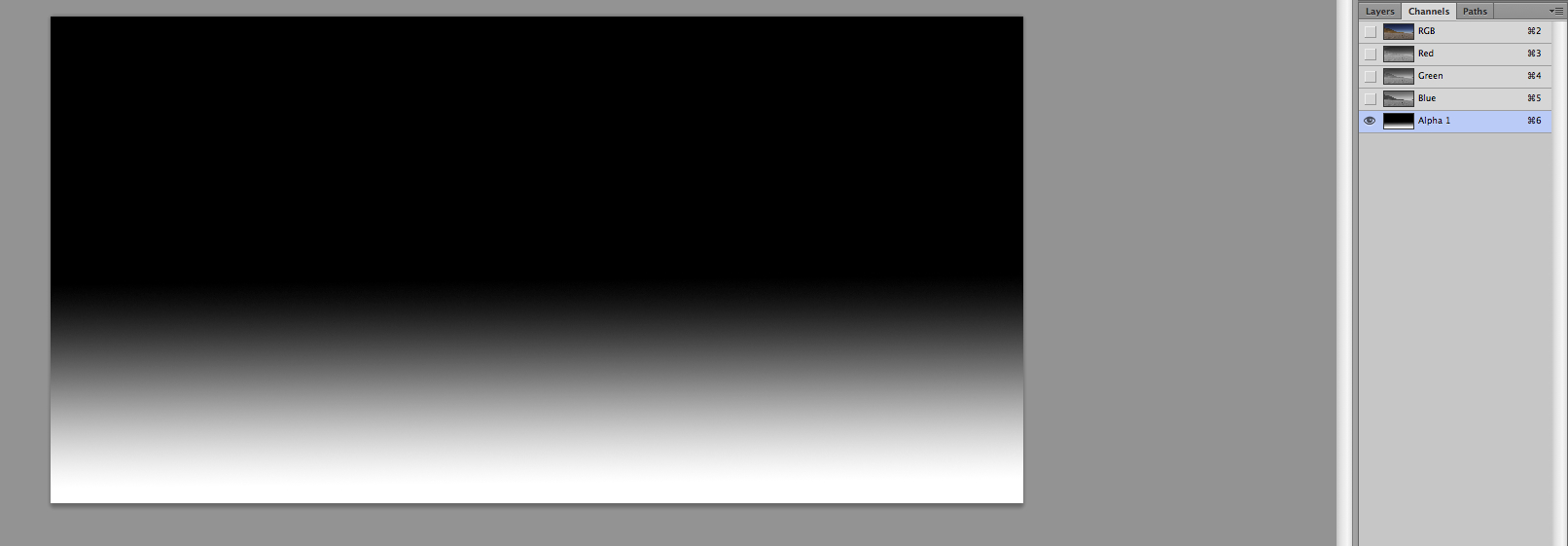

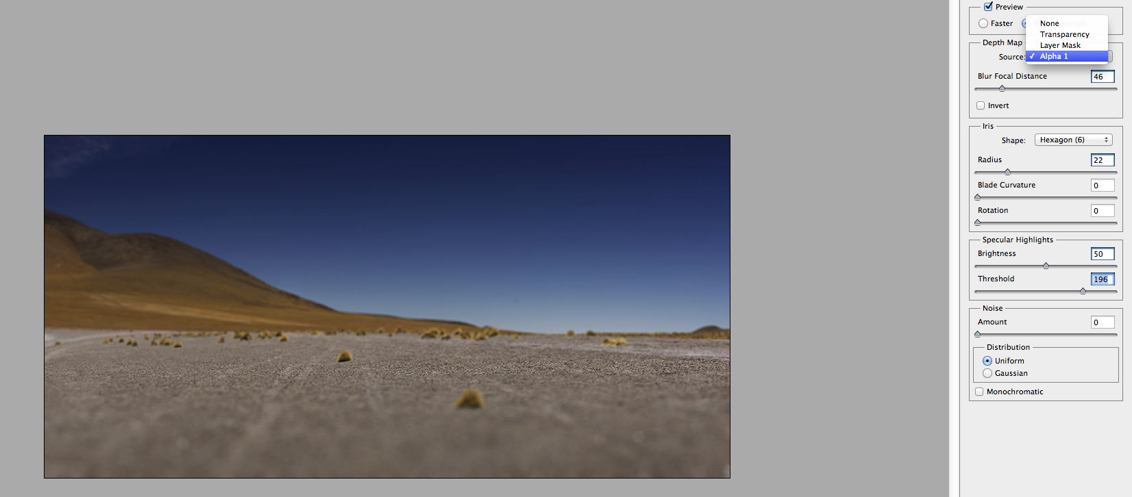

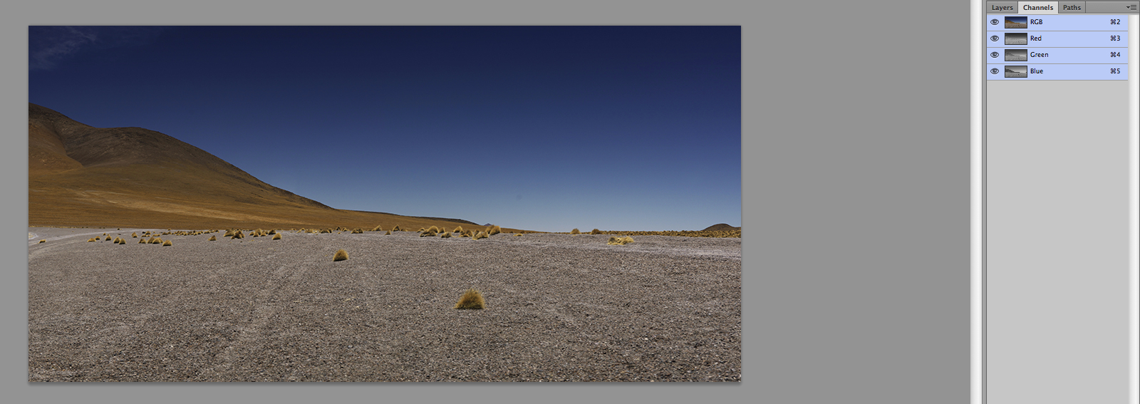

Step 1: Open the channels tab of the image you want to blur, and create a new channel - should be called alpha 1.
Step 2: Copy your depth map and paste it into the alpha channel that you just created.
Step 3: Hide the alpha channel, open the Lens Blur filter and select Alpha 1 as the source.
Step 4: Tweak away!
Hope that helps.
