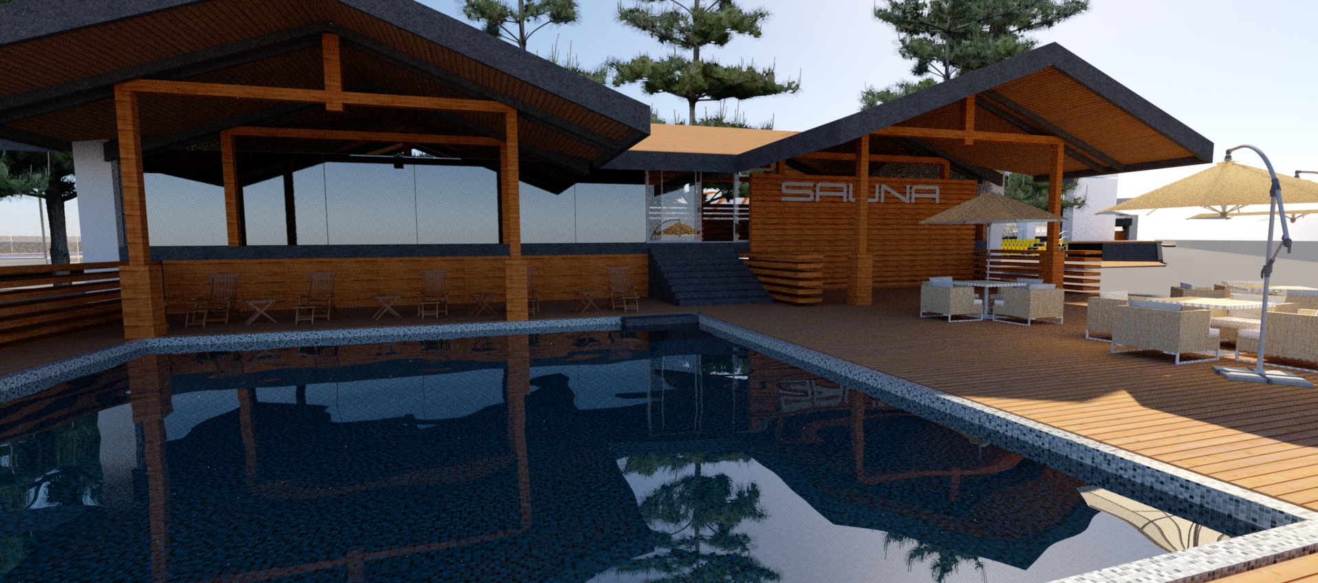

I apologize if this topic has been around, but I'm tired of searching a solution.
I need to make clear water for the pool, which will transmit light. I installed the material Rippled water, but it does not transmit light.
What is my mistake? How to fix it?

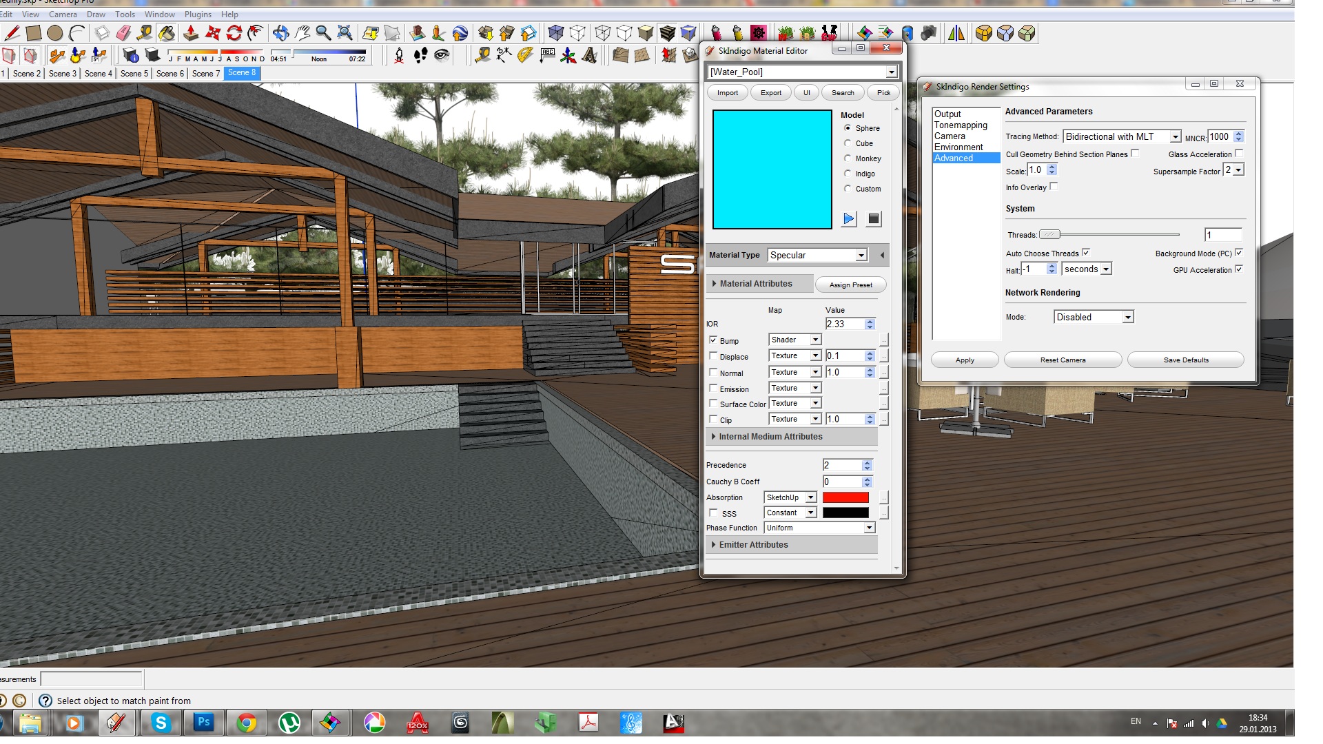

Post by Zom-B » Wed Jan 30, 2013 2:25 am
change rendermode to MLT+Bidir :)

Zom-B wrote:change rendermode to MLT+Bidir :)
I use this method, but it does not work
Re: problems with transparency
Post by CTZn » Wed Jan 30, 2013 2:49 am
Also make sure that the water surface is intersecting the pool walls a bit in order to secure a closed volume.

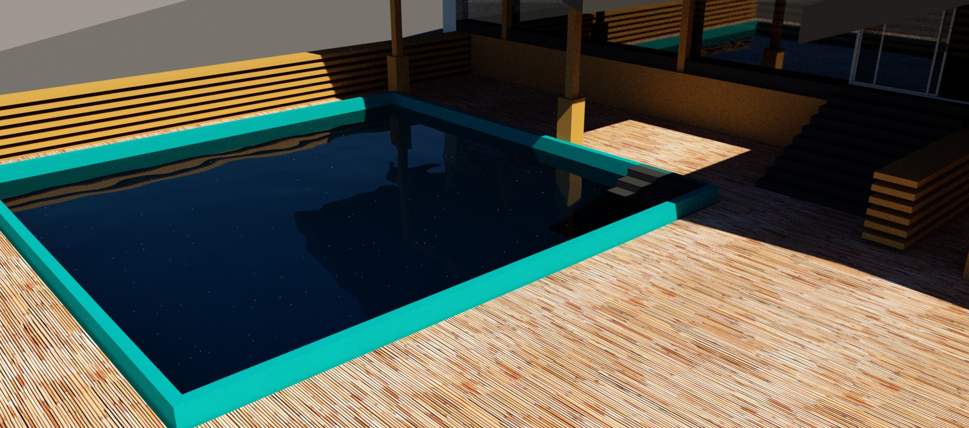

tigartos wrote:Thank you very much, everything was as I wanted
If you think so, then show me the sun shining inside your pool :P

you are right
It's not as good as I expected, the water looks realistic only when it does not get sunlight.
Post by Zom-B » Wed Jan 30, 2013 4:45 am
tigartos wrote:you are right
This is a general Problem with PathTracing, Sun light and specular materials.

Yup, pathtracing and caustics don't mix we'll.

Also, the water material shoud have less opacity since it's a very thick solid and color absorption is proportional to thickness.
