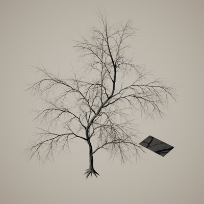

However, I'm having a problem with external OBJ files. In Indigo v2 I had a scene set up which had several trees referenced in and it worked really well. Now, when using v3 and after using the 'Edit Active Mesh' referencing in SkIndigo, the trees won't show up! The trees are in the OpenGL preview (and to scale), but not in the rendered scene.

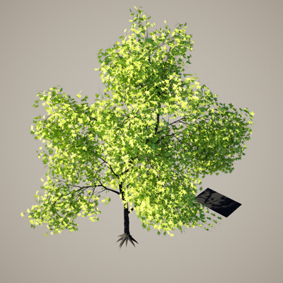

I tried a test scene and noticed something a bit strange. When referencing one tree in with basic colours for the bark and leaves the external OBJ shows up. However, if I apply a texture to it then those elements of the tree disappear.
The above render has just plain colours assigned for the bark and leaves. I have a test swatch beneath the tree also

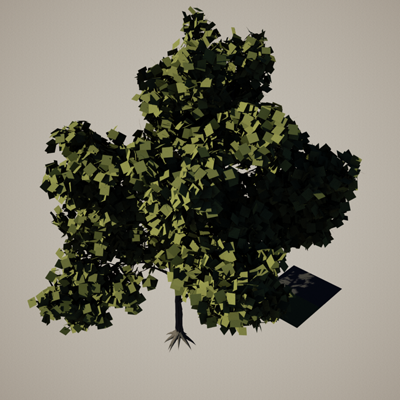

This one has the leaf colour replaced by a leaf texture and it disappears!! The swatch has also gone.
Am I missing something crucial? I thought I'd followed all the steps right! :-p Please help!

Just to update... I looked at the textures a little further and realised they were TIF files.
After changing them to PNGs the render worked!! Have TIFs been disabled in the new release of Indigo?

Did you adjust the color of the TIF texture in SketchUp? I think this can create problems.
Try resetting the color to the original texture color and see if the TIF versions works.

Whaat wrote:Hi,
Hi Whaat,
Yep, that appears to have been the problem. Thanks! :-) I presume there's something sketchup does to the TIF file that makes it un-usable?

gjengi wrote:
Whaat wrote:Hi,
Hi Whaat,
Yeah, I think SketchUp does something to the texture that Indigo does not like. However, I need to look into this a bit more to confirm the issue.
You can still use Photoshop to color change the texture and then use external textures instead.
