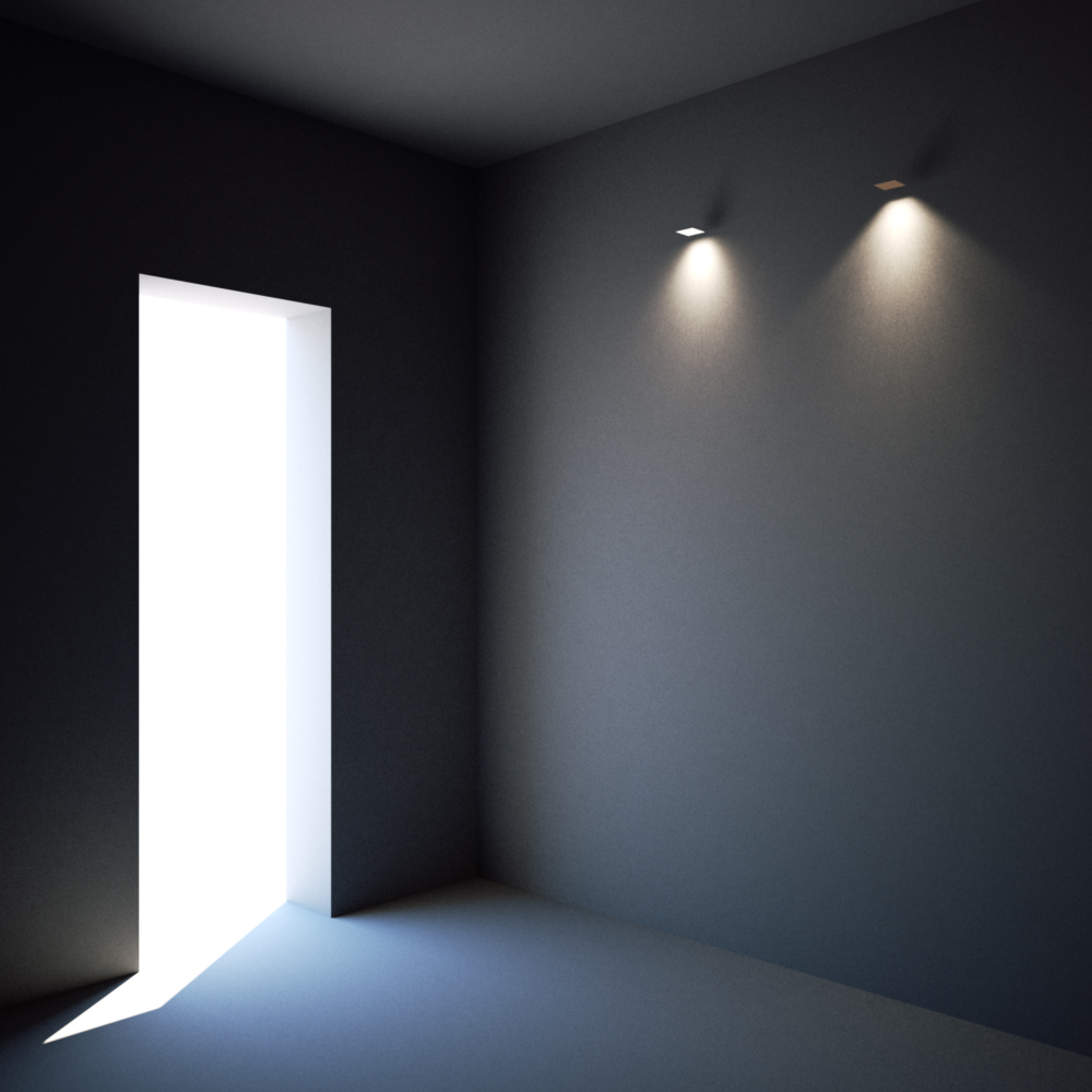

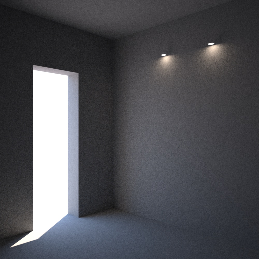

Hello, I have been experimenting with IES Lights and no matter what kind of external IES path I use i get the same result. There is no change in the light.
Also If I render Reinhard the lights are OK but if I render in Camera mode the render is all white, so I have to lower the iso to 1 to get a decent image, and no matters if I lower the emission scale at the material editor the light amount is the same.
Here is exactly what I do, I create a room with floor, roof and 3 walls, I chose a color black (008) in sketchup and change the name to light, then In material editor select diffuse, change the light layer, and just click in the IES path and select a path. ( I have several ) some work and some don't, but the ones who work are giving me the same light.
Also I have a lot of Issues like network rendering (not working), environment maps (not working), also If I select sketchup background color black (not working, the sun stills there)
I don't know if I have this problems because I´m using skindigo 3.0.15 or Is the same in 3.0.14.
Am I doing something wrong?
have a MacBook Pro OS 10.7.1
Sketchup 8
Skindigo 3.0.15
Indigo 3.0.14
Thanks
No matter what IES path I select I get the same result

Thanks Allfrad, I'm checking it soon, I'll tell you if I confirm this bug.
Re: IES LIGHTS, all paths are giving me the same light.
Post by Pibuz » Fri Sep 02, 2011 8:55 pm
No problems here, although there's still an issue with base surfaces not glowing sometimes :?

I tested your file, and I still have the same problem...
Are you using mac? Maybe is because I have Lion installed..

check....
IES2 in your's is "white".... on Pibuz render is brown
check IES path

I had Installed Indigo 2 and 3.0.14 in the same computer, so I uninstall all Indigo Programs and re Install only indigo 3.0.14 and It is working now !!! :D
thanks a lot!
