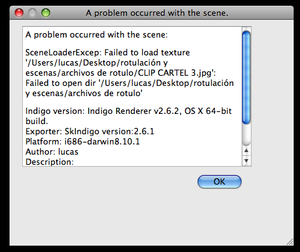

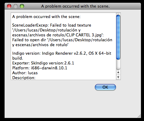

I am using a clip texture wich is referenced. When I export the scene and try to render it in another computer I get this message (see picture).
I have tried loading the scene in from sketchup into indigo---- then packing a .PIGS file ---- theeeen render in another computer = it works.
Still, I have my doubts on the whole exporting - resuming subject. It also seems as if once the scene is rendered in one computer, it cannot be resumed in another. (the error message window says something about different buffer sizes)
Re: referenced CLIP maps don't load?
Post by Pibuz » Fri Mar 25, 2011 8:21 pm
..I fear it is a typing problem. Try to put you files in folders NOT using special characters (I see "rotulaciòn" in the name, ò is a special character).
