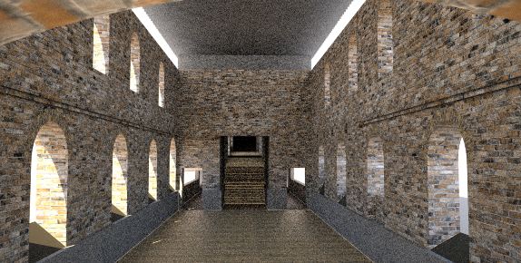

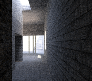

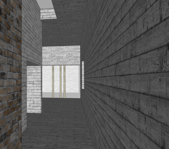

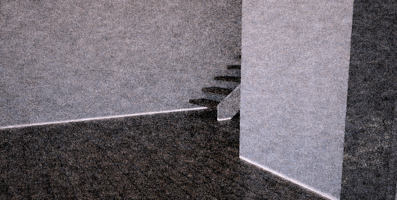

I seem to have a problem with light appearing at the edges of my floor planes.
I've had this problem for a while now and when it initially happened I found out that it seemed to be linked to the size of the model - e.g. the further away you were from sketchup's origin, the worse it got. It seems to be most obvious during darker views, such as indoor shots. So I did the interior shots with smaller models, and nearer to the origin to avoid any problems.
However, I started rendering something today and the problem has occurred again, but on what is a fairly reasonably sized model. The Sketchup models are modelled in a very basic way, and with no displacement applied to materials, just bumps.
Can anyone help? I've attached some images below showing the problem. Apologies for noise, I didn't have time to leave them going too long.

I've found a temporary fix for it, which is to put a big ground plane a few metres beneath the floor to block out the ambient light. It just seems a bit excessive, and I would've thought that the wall and floor would stop any light coming through?

Odd! I suppose the obvious question which I'm sure you've double checked is that there is no actual gaps in the model? ie, your walls actually meet the floors 100%?
I can't think of any other reason for light to leak through where there are no gaps I have to say.
Can you share the model file then some of us can run it on our own systems and see if the problem is recreated?
