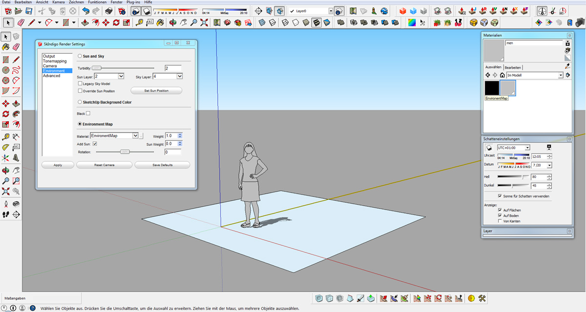

Do you have a solution about the problem with the environment map? Whatever render method I use, the model turns black, as if the "add sun" option doesn't work. If there is no solution, I will have to uninstall this version and use the previous one :?: (need to finish my project until this weekend).

Yes, I need the sun option. Only Env Map with gamma doesn't give me shadows. My model is placed in a photo, so model and photo shadows should be similar. I always take my own panorama at the site and use ptgui to create a hdri or exr env map, then use it for my model for lighting and reflections. This worked fine until 3.8, though there always were issues about balance between env map and sun.

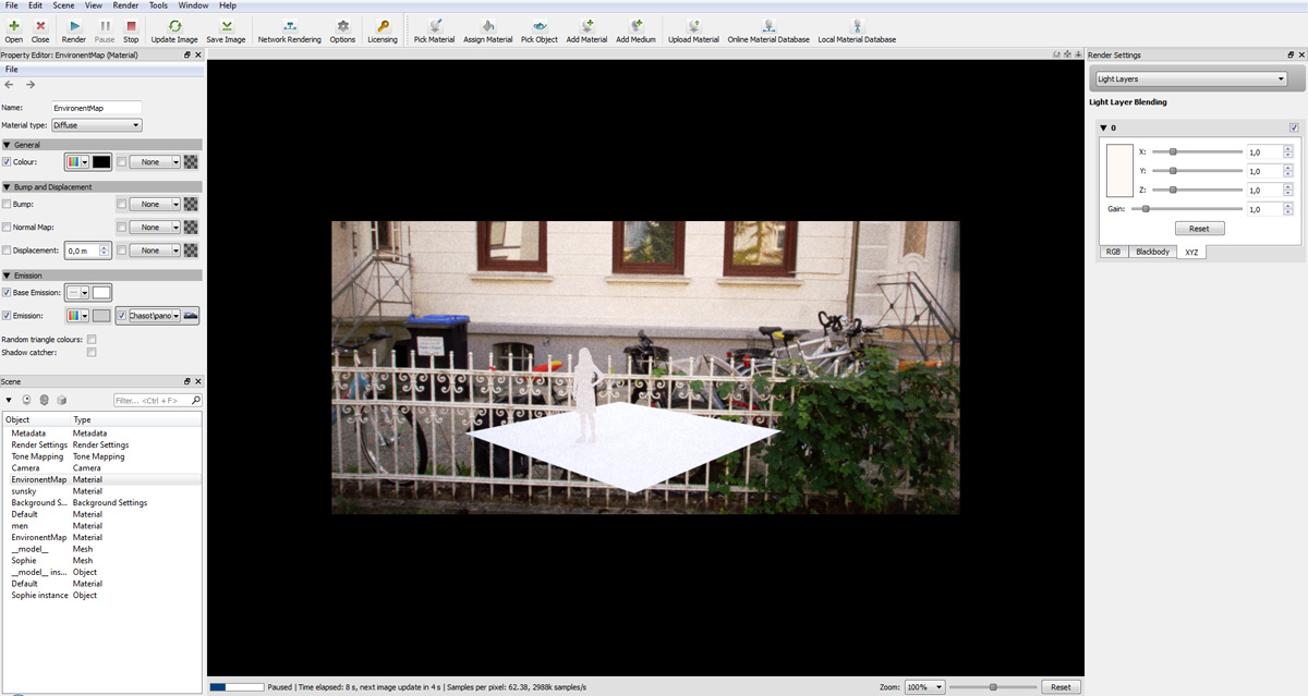

Thank for the update,but now I get this:
The option for light layers doest not work in Indigo, and I only get lighting by env map, no sun... :?
Or did I miss something?

...when I set sun weight to 1 or any else value thsi happens:
An error occurred while SkIndigo was exporting the scene.
Please copy and paste the following details into an email to support@indigorenderer.com:
SkIndigo version: 3.6.28.3
SketchUp version: 14.1.1282
Ruby platform: i386-mingw32
Error during processing: undefined local variable or method `used_layers_array' for #<IndigoExporter:0xbeeceb8>
C:/Users/Knopp/AppData/Roaming/SketchUp/SketchUp 2014/SketchUp/Plugins/skindigo/skindigo_core.rb:10019:in `export_environment'
C:/Users/Knopp/AppData/Roaming/SketchUp/SketchUp 2014/SketchUp/Plugins/skindigo/skindigo_core.rb:955:in `export'
C:/Users/Knopp/AppData/Roaming/SketchUp/SketchUp 2014/SketchUp/Plugins/skindigo/skindigo_core.rb:11606:in `block in <top (required)>'
-e:1:in `call'
24 hours isn't enough
http://www.werkraum3d.com
lape
Posts: 241
Re: SkIndigo 3.6.8.1
Post by lape » Fri Aug 01, 2014 2:05 am
oooops, all my fault. :shock:
just forgot to reinstall latest SkIndigo exporter! Now everything works. Env map +sun ok.
Thank you Ono, you saved my weekend! :mrgreen:
