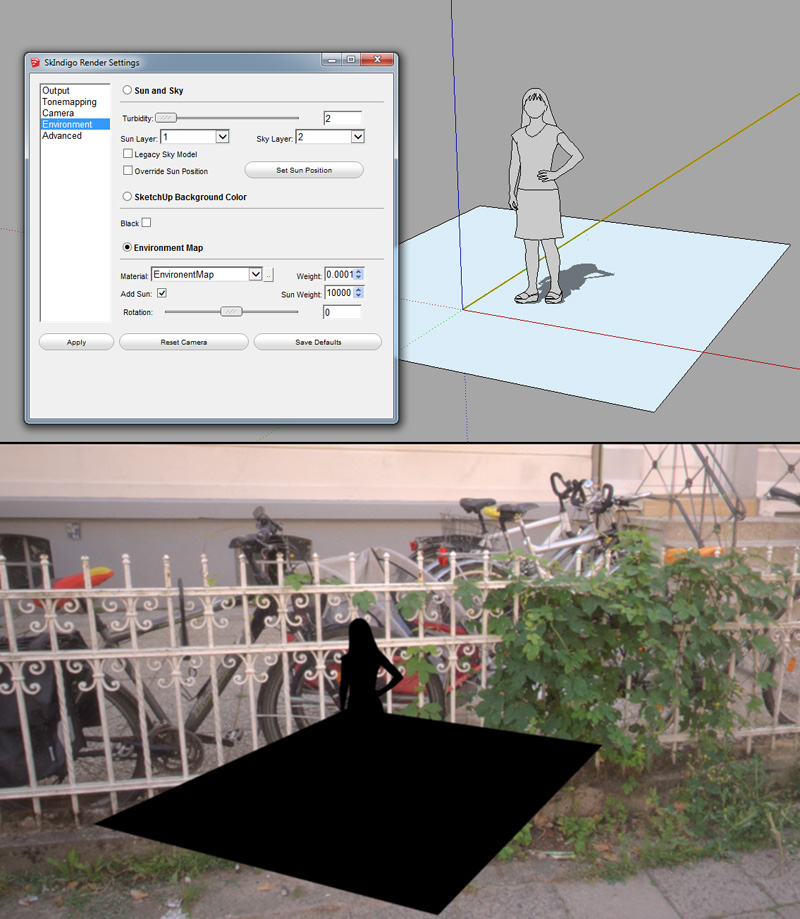

The worst thing is that i cannot get my environment map work!
Now I am back on 3.8., and this is what happens, see attached screenshots.

Re: SkIndigo 3.6.8.1
Post by OnoSendai » Wed Jul 30, 2014 8:45 am
lape wrote:The worst thing is that i cannot get my environment map work!
Can you send me the .skp file?
Post by OnoSendai » Wed Jul 30, 2014 9:54 am
This seems to be an issue with sun + env map with bidir enabled. Just avoid that combination for now.

Post by lape » Wed Jul 30, 2014 10:16 am
No, it also doesn't work using path tracing, can't get the sun layer working while environment map is in use! And if you use camera instead of reinhard, everything turns black...
