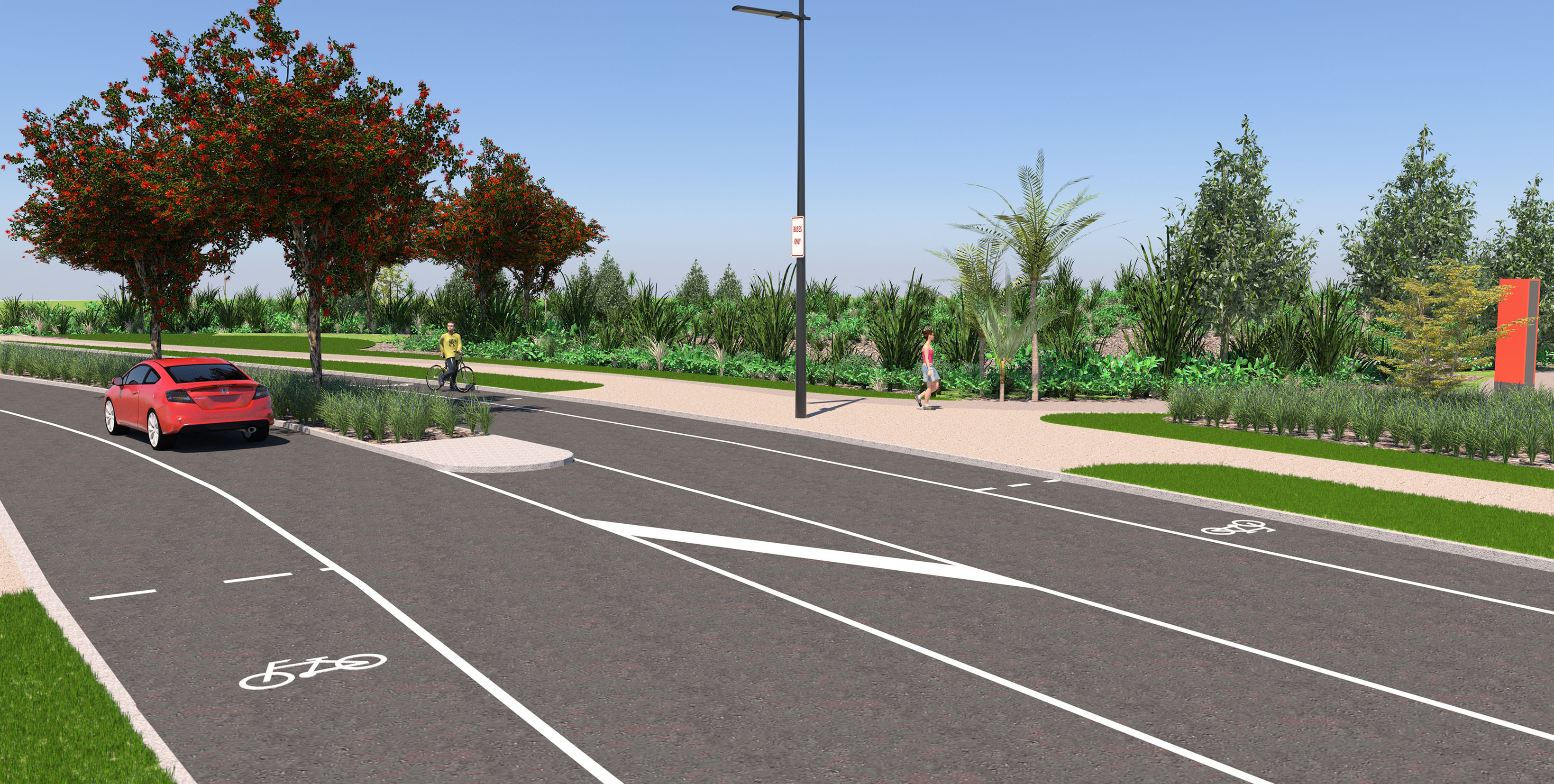

I've attached a scene I'm working on...crappy subject and (road medians) but this one has 3 types of scattering..shrubs, grasses and long wavy grasses, plus lots of other instancing. I think the grass really gives it another level of realism! In the past this diagram would have been done as a 2D plan or maybe a basic 3d sketch, but having Skindigo set up for quick rendering means that even simple diagrams can be done in this fashion for virtually no extra time-cost.
Environment maps and glass are two aspects I'm still struggling with :( (no more thin glass?)

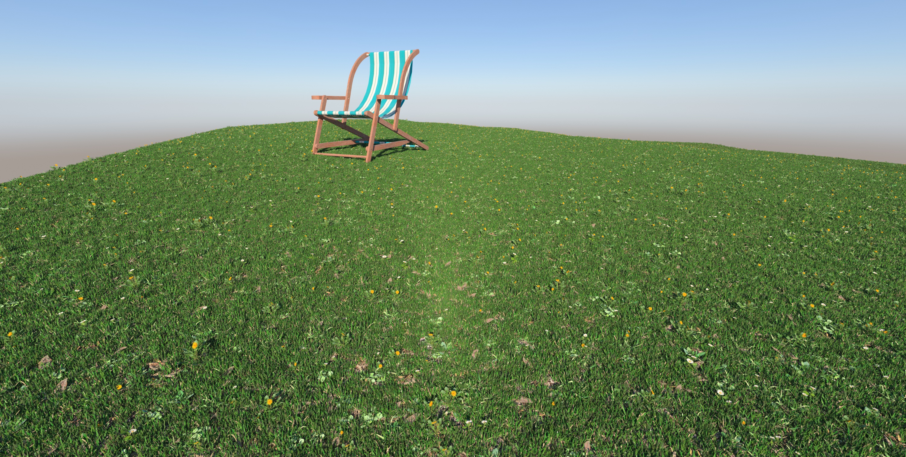

Re: Wanted: Scatter presets

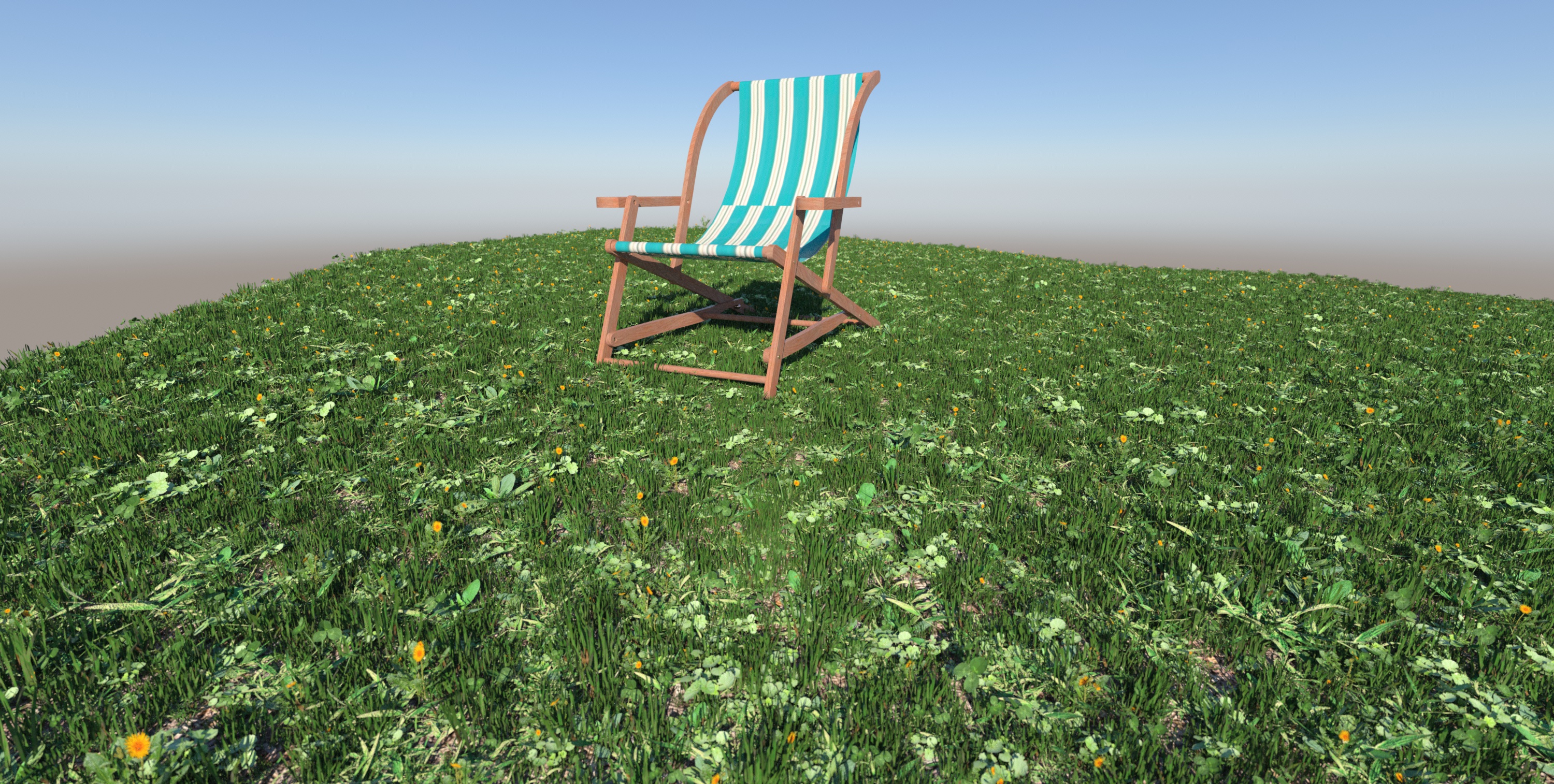

Post by ak-sam » Wed Sep 24, 2014 2:29 pm
Don't laugh, my lawn really does look like this :(
Sams Lawn.zip
(2.88 MiB) Downloaded 693 times

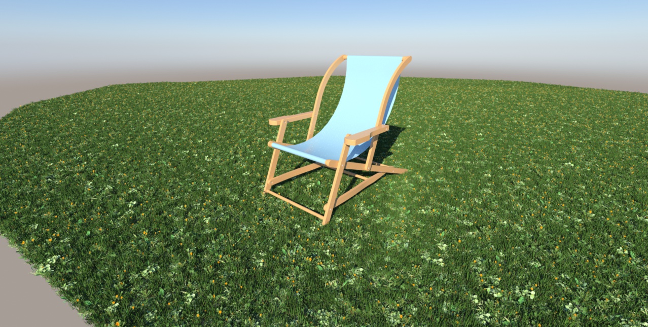

Post by ak-sam » Fri Sep 26, 2014 9:38 am
I'm still experimenting with the presets...this is a rougher style.
Skindigo on 1x 6950x, 1x3970x, 6x3930k, 2x4930k, 3x5930k
Post by OnoSendai » Fri Sep 26, 2014 12:09 pm
Thanks Sam, will look at these soon!

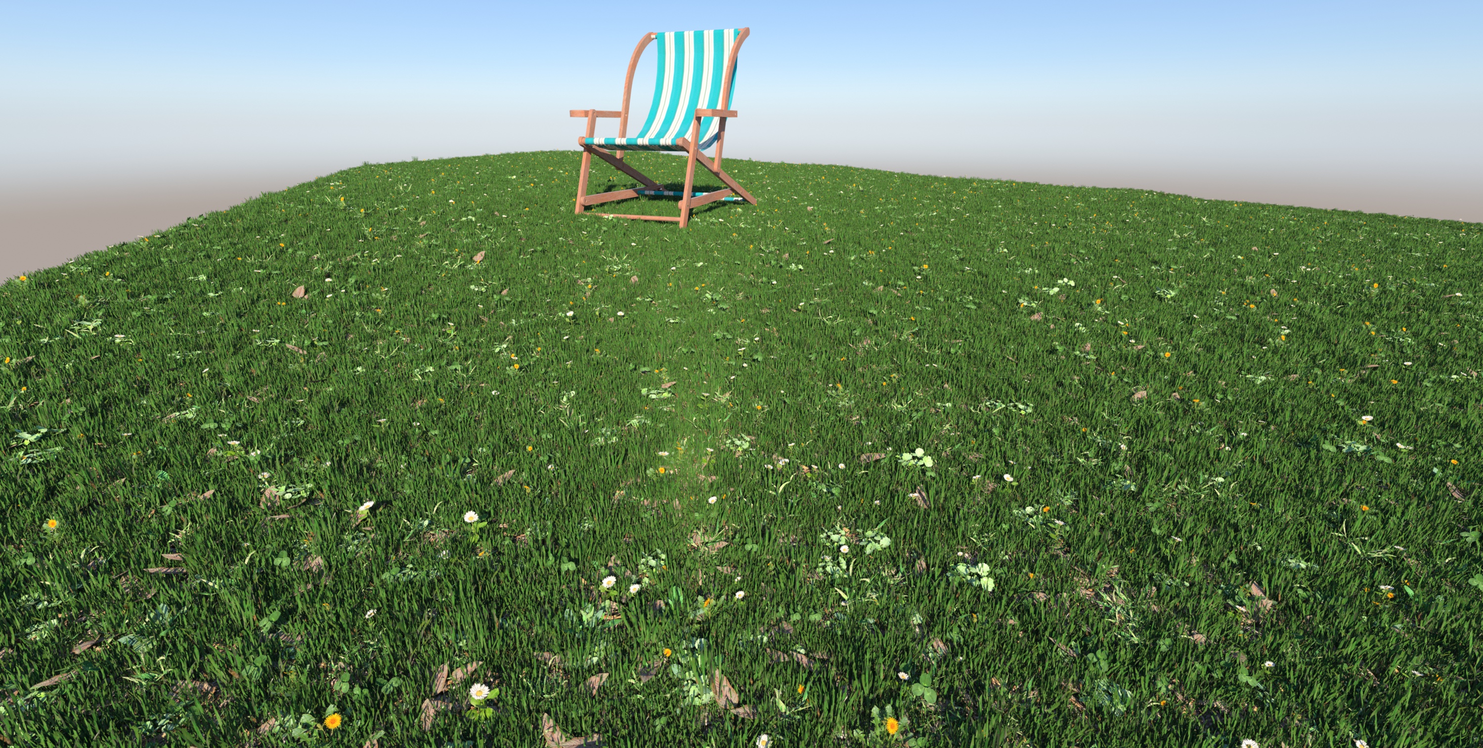

Post by ak-sam » Fri Sep 26, 2014 12:35 pm

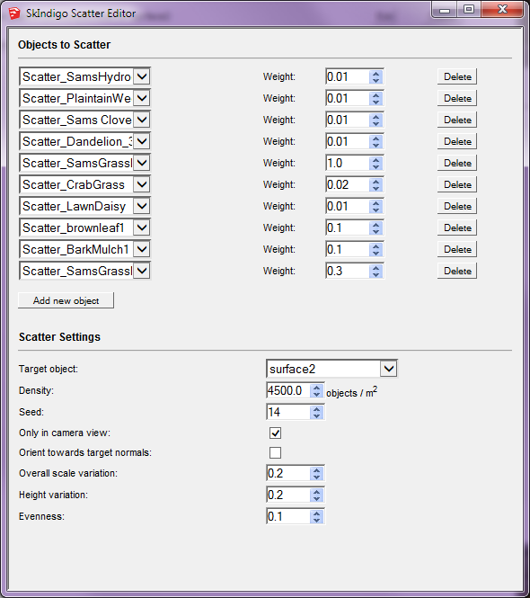

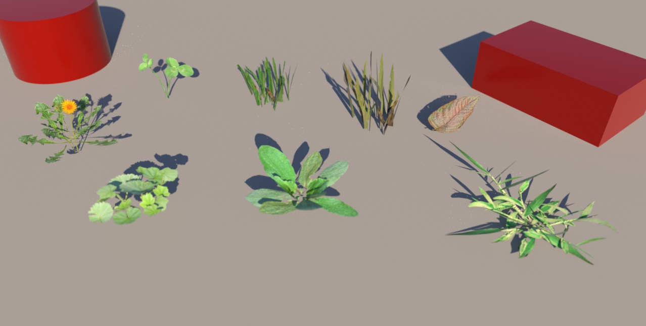

I've made a lawn daisy and added that. Also some bark mulch (not easy... need lots of variation otherwise it looks terrible.. maybe easier to do with a bump/displacement map etc?)
I'm still struggling with the distribution. Are the seed numbers repeatable, eg, if we find a seed that gives a nice natural (clumped) distribution, could we use the same number in different scenes for a similar effect?
The attached scene has all my components.
Sams Lawn Rough.zip
(4.88 MiB) Downloaded 768 times
Post by Zom-B » Fri Sep 26, 2014 5:48 pm
Looking good Sam!
My only suggestions would be to have the grass maybe not only that streight pointing up, but a little more to the sides too, generally speaking, the longer the grass the more it bends to the sides.
Also your material look quite... solid. What do you use here?
keep it up!
Post by ak-sam » Mon Sep 29, 2014 8:29 am
Thanks guys, happy to help.
Zom-B wrote:Looking good Sam!
keep it up!
Good idea about the bendy grass! I need to review.... What happened is that I started with very short grass, but I increased the length once I started adding weeds, because it's more difficult to keep everything in scale. Also the scatter length variation modifier can make grass look longer than intended.
"Solid" meaning not opaque?
I'm using phong materials to keep rendering times down, but I expect Ono will modify the materials to be more optimised when he creates the presets. Double-sided thin would be nice. Translucent materials would be perfect but I think might take too long to render.

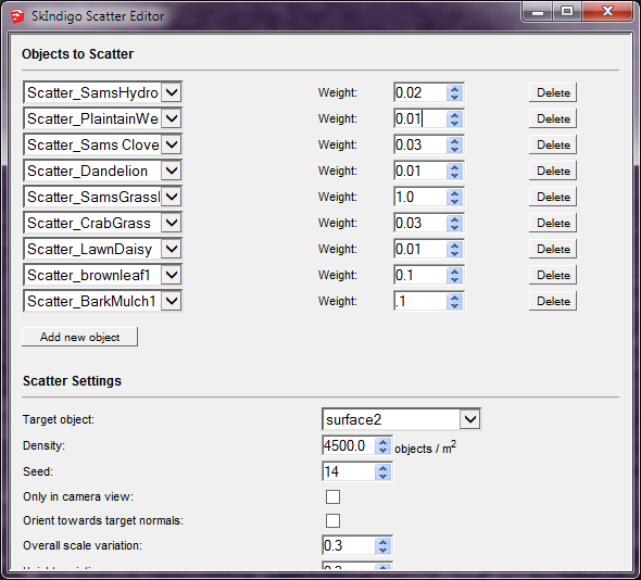

Post by ak-sam » Mon Sep 29, 2014 9:30 am
This is getting fairly complex...
4500 instances per square metre.
I'm getting 890 samples/second using bidirectional path tracing (single PC).
I'm happy with this result though, I'll be using this in my scenes from now on.
It certainly looks better (to me) than any other 3D rendering software's default grass.
