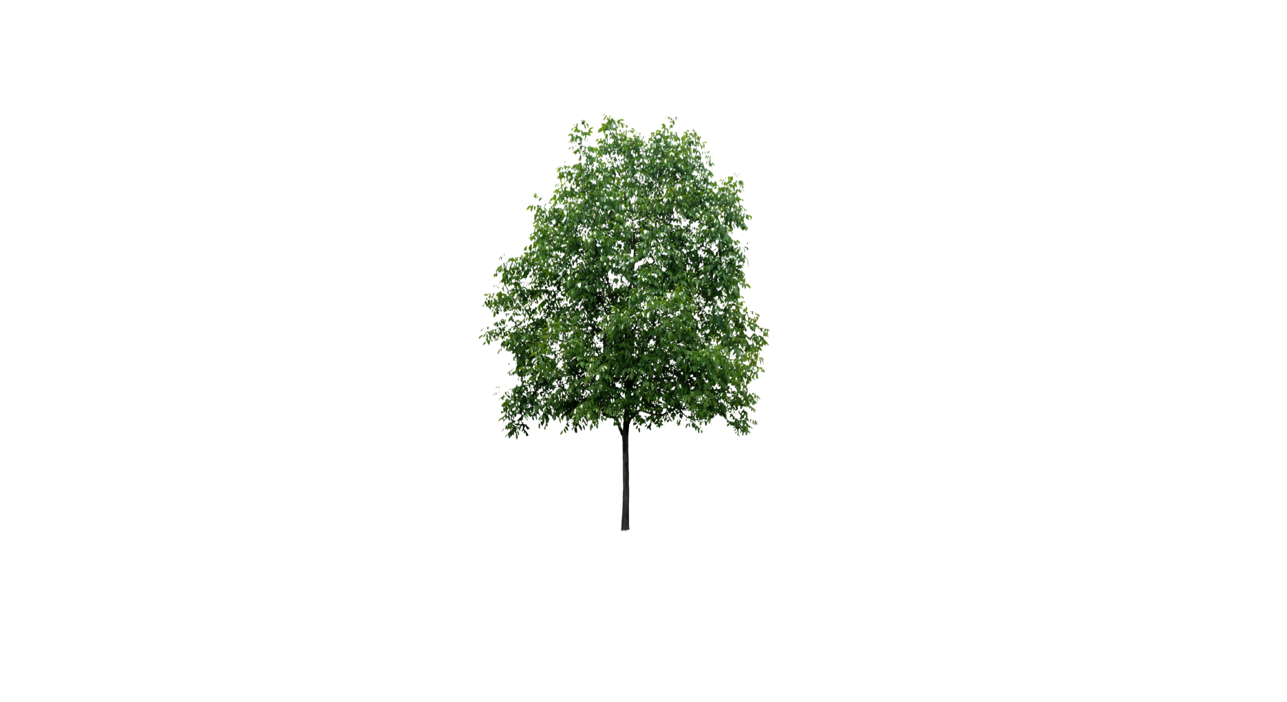

I tried this instancing method and I got the model to load into indigo with all the correct materials, but it doesn't seem to keep the tree object in the correct location or orientation. No matter how far I zoom out, when the image loads in indigo the tree is always appearing right in front of the camera. Any ideas on how to fix this?

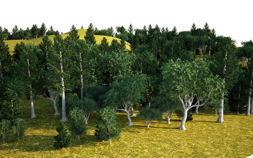

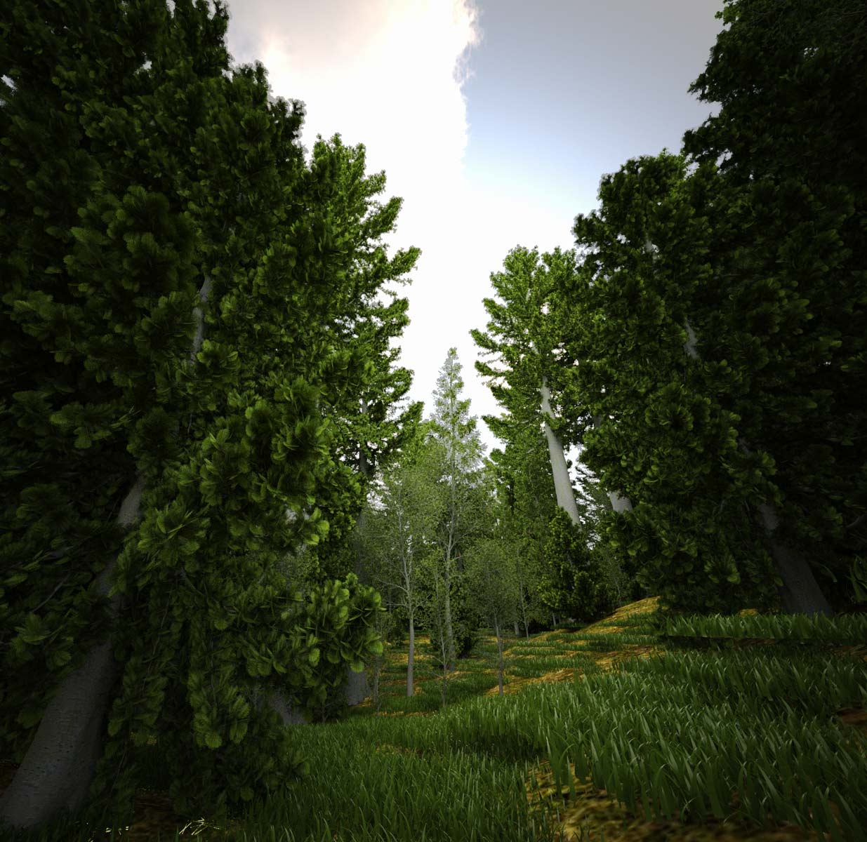

Actually, it does work on mac! Sorry for the misleading information earlier. I was doing something wrong.
From this.
To this!

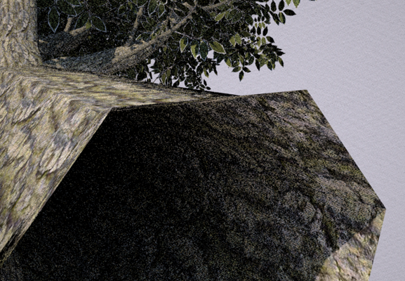

So here's the problem I'm running into.
I'm using some xFrog trees that I have that need to be scaled by a factor of .0254 (as revealed by the illustrious Snorky) in order to be rendered in the proper size when referenced as an external mesh. I've been using Meshlab to do the scaling and resaving, and it does a great job, especially for a free program!
Unfortunately here's where the problems arise. After exporting a file from Meshlab and linking it as an external mesh in skindigo, the textures appear to lose their naming and take on some sort of default name (eg material_0, material_1, etc). This isn't a problem when using only one external reference, but when using multiple external meshes the names quickly start to overlap, as they're all looking for "material_0". I end up with forests that look like this:
Different trees, same leaves!
Firs with birch bark and conifer leaves. Lovely.

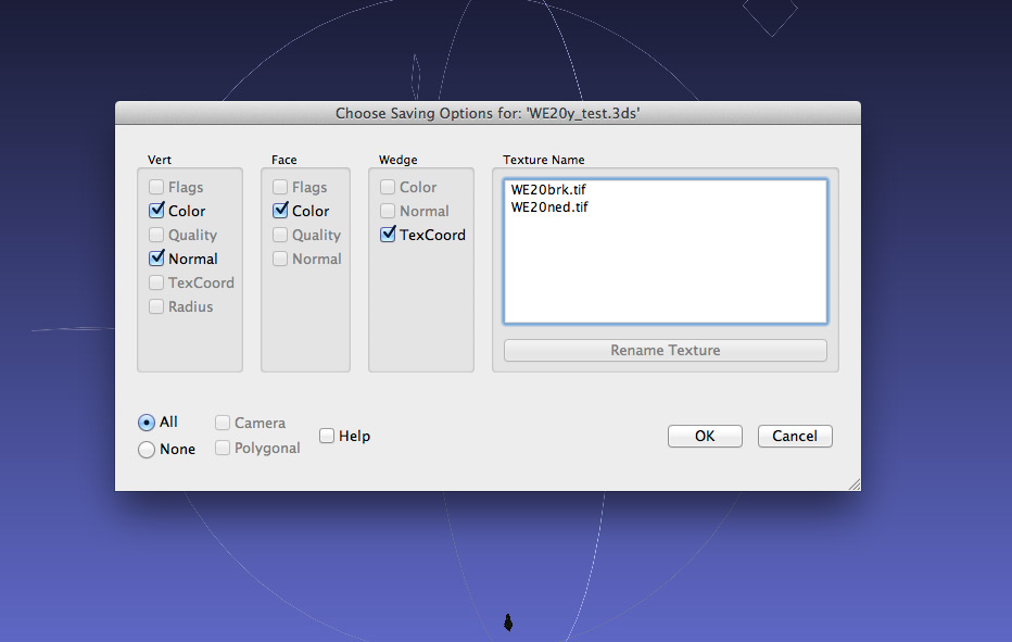

It seems the issues is in Meshlab's renaming of the textures on export. It gives a prompt to rename the textures on export but when I try it use it it crashes pretty hard. Here's what the prompt looks like.
Texture Prompt
So, any clues as to a workaround? Or is there another program that can edit .obj or .3ds files that also would allow me to rename textures so they don't overlap?
