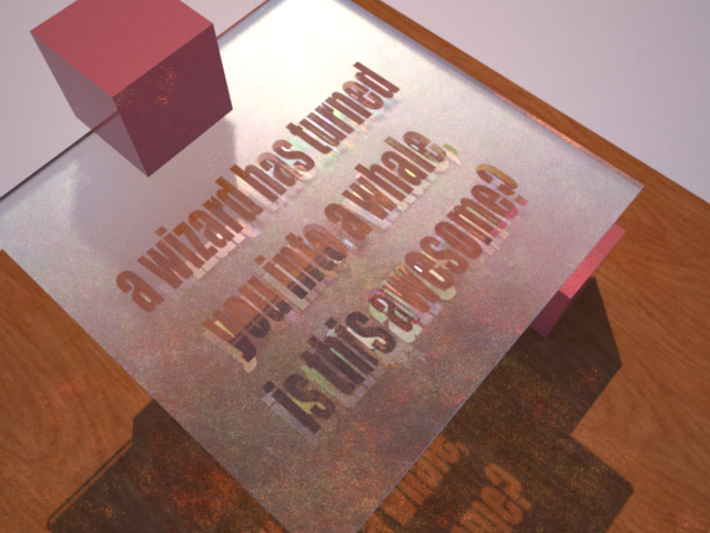

... well i got some green going on now. i guess the only thing that looks funny to me is the shadow ... should frosted glass create such a solid shadow? imma leave this one cook longer to see if it clears up. perhaps it is related to the rendering method i'm using. all of these have been straight MLT no bidir and no hybrid.
Post by Kram1032 » Fri Jun 27, 2008 6:54 am
t's not an entirely solid shadow... I guess that's valid. Just think about a fully colourles SSS thingy... Although it absorbs nothing, it makes a solid shadow.
In this case, the scattering is limited to the surface, which causes some caustics to show through. The shadow is very likely to be correct.
(Oh, just saw it: I've the reality-example directly a little left of in front of my nose. frosted glass definitely throws solid shadows.)

Post by zsouthboy » Fri Jun 27, 2008 7:18 am
Yeah it makes a shadow because the light scatters instead of going directly through = attenuation.

Post by cpfresh » Fri Jun 27, 2008 9:16 am
ok finished render ... not so great i think. it seems to me that the cube would be reflected more in the shiny letters than it is ... anyways, gonna try one last time from a different angle.
