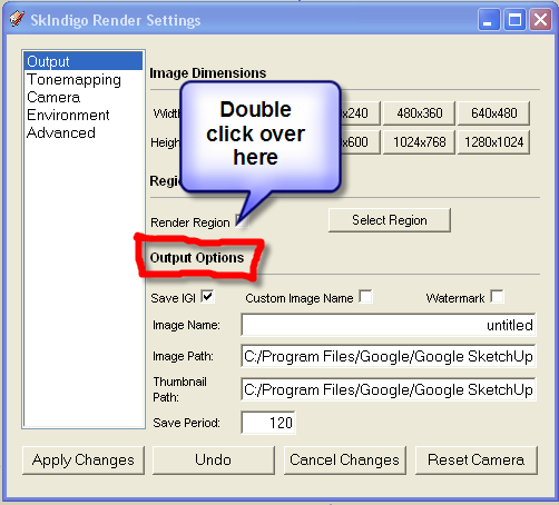

kwistenbiebel wrote:
A QUICK GUIDE TO SAVE THE BATCH.EXE FILE
Actually, rendering animations is a hidden feature.
To use it, go to the render settings screen of Skindigo ---> 'options' tab.
Double click on the words 'output options'.
A window will pop up that lets you save the batch.exe.
It will ask you which framerate you want.
I chose 10 frames per second, but for a really smooth animation consider 25 fps (if you have a render farm ;))
I dont know how but I dont see the options tab in my skindigo when I go into render settings. Please help!
Rodrigonotor
Posts: 19
Joined: Wed May 21, 2008 7:24 am
Post by Rodrigonotor » Wed Jun 04, 2008 4:00 am
Double click over the text "Output Options"
kwistenbiebel
Posts: 496
Joined: Sat Jan 27, 2007 12:31 am
Post by kwistenbiebel » Wed Jun 04, 2008 5:57 am
Sometimes the image says more than the words... :)
