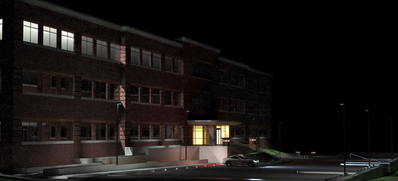

Hmm, maybe I don't understand, but I haven't had any problems with glass as long as it was a light thickness, I usually stay with 1/16" and set the glass preset. Here is an attached exterior, it certainly isn't that great of a render, but it shows the glass. is this what you guys are talking about, or are you trying a different effect, or.... I've also done some interiors with sunlight coming through the glass and haven't had any problems, other than the multiple day rendering times :shock:
manitwo
Posts: 1029
Location: Tirol - Austria
Post by manitwo » Tue May 15, 2007 4:36 am
:o great pic crc!
Post by OnoSendai » Tue May 15, 2007 4:37 am
Yeah, just needs some moonlit clouds :)
Post by Kram1032 » Tue May 15, 2007 4:43 am
Is that a hidden message, Ono? :D:D:D:D:D:D:D:D:D:D:D
Great pic and Ono is right ;)
crc
Posts: 153
Joined: Wed Feb 28, 2007 9:30 am
Location: Portland, Oregon
Post by crc » Tue May 15, 2007 4:47 am
thanks guys, it was mostly just a test, hadn't done a nighttime exterior scene.
Needs some stuff inside the building instead of just being a big hollow shell, but the lights coming out onto the brick turned out nice I thought, and the car lights also.
thanks again!
