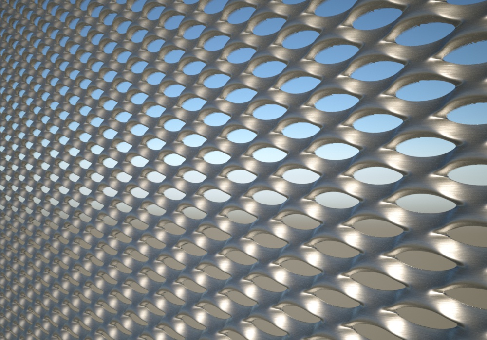

sunlooksgreen wrote: @ono do you see a workaround for the extended gap problem at the beginning of the cut (no tangency of the two sides separating, more like an U)?
also, do you think this material could be done on isl? is it feasible with such complex geometry?
The rounded gap corners are just there because I "hacked" up the alpha map (clip map) in an image editor to make the gaps larger. The better solution is to leave the alpha map the same and change the displacement map.
I might have a crack at it in ISL. I'm not sure exactly which shape to go for tho, there seem to be a few different ways of stamping out this metal.

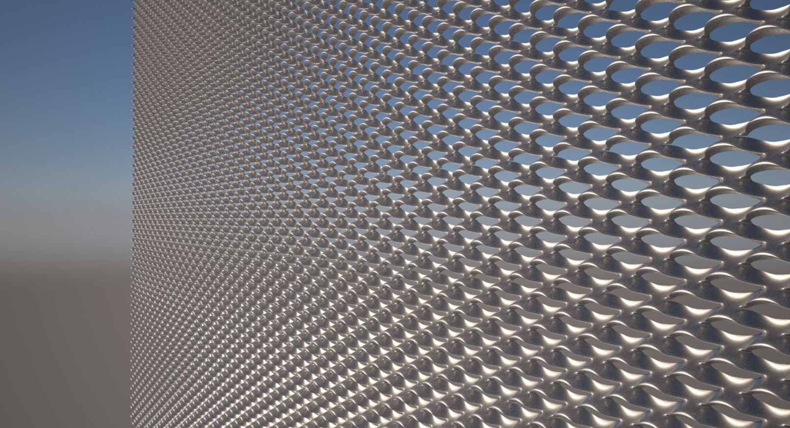

Thanks Ono! This definately made a big improvement for me. Not perfect, but for anything other than an extreme close-up I really don't think you'd notice on mine now.

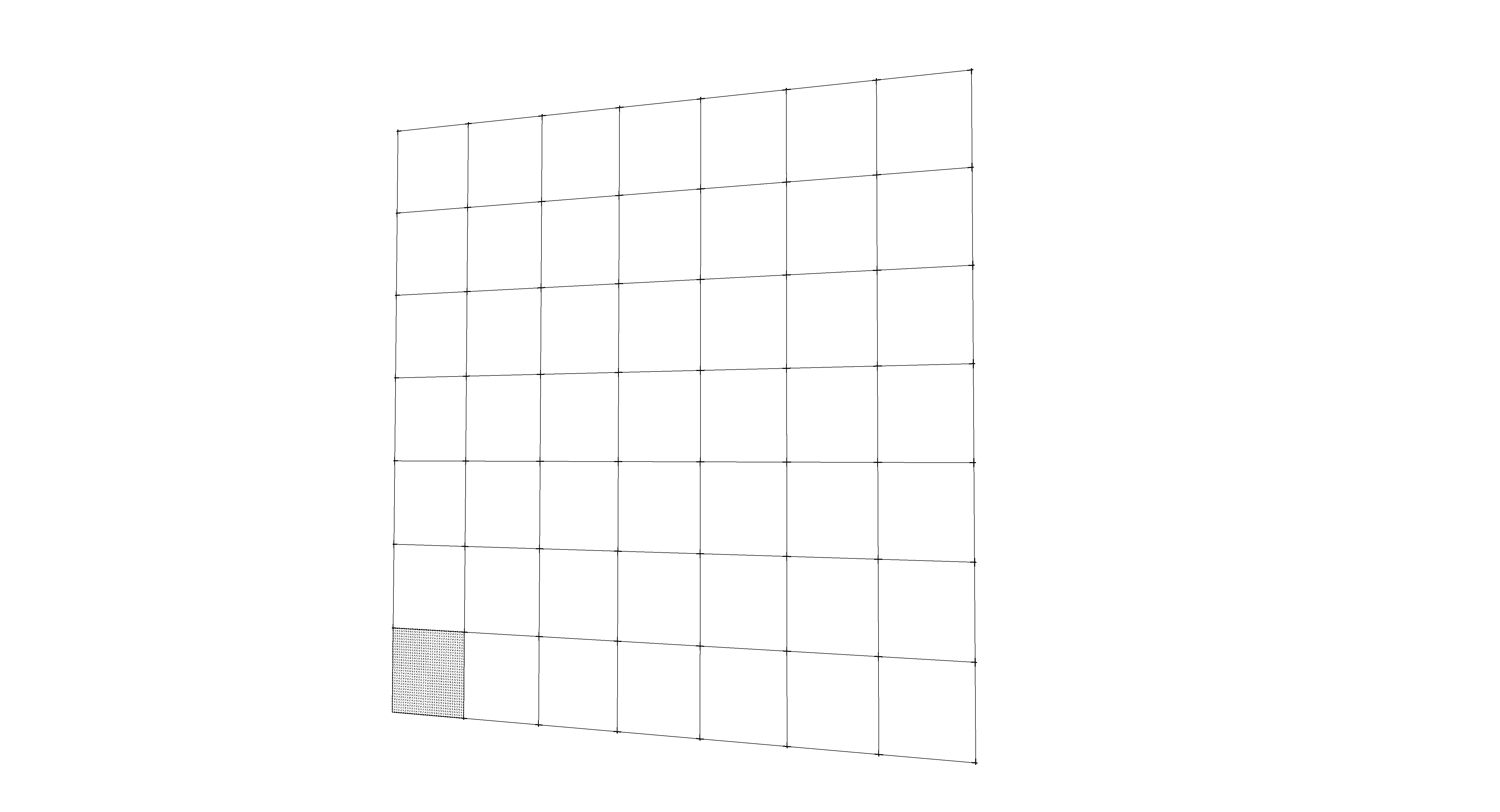

If you're worried about massive subdiv - on a repeated displaced texture like this I always make a small subdivided component (say 600x600mm for this material) and then make dummies to reference that. Means you only have a small section within SketchUp with a lot of geometry, but it still renders perfectly.

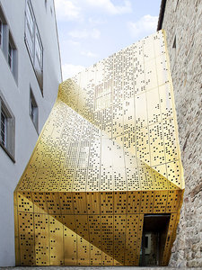

@bubs thanks for the tip, but the dummies strategy wouldn't be practical on models with complex envelopes where openings/boundaries don't follow horizontal vertical modulated patterns

no.. it was just to illustrate a case with a complex envelope; i meant.. just imagine you have to do such façade, with expanded metal and some big openings (no mix of holes+expanded..sorry to create confusion)

The new 3.8.6 release seems to have sorted this issue!
