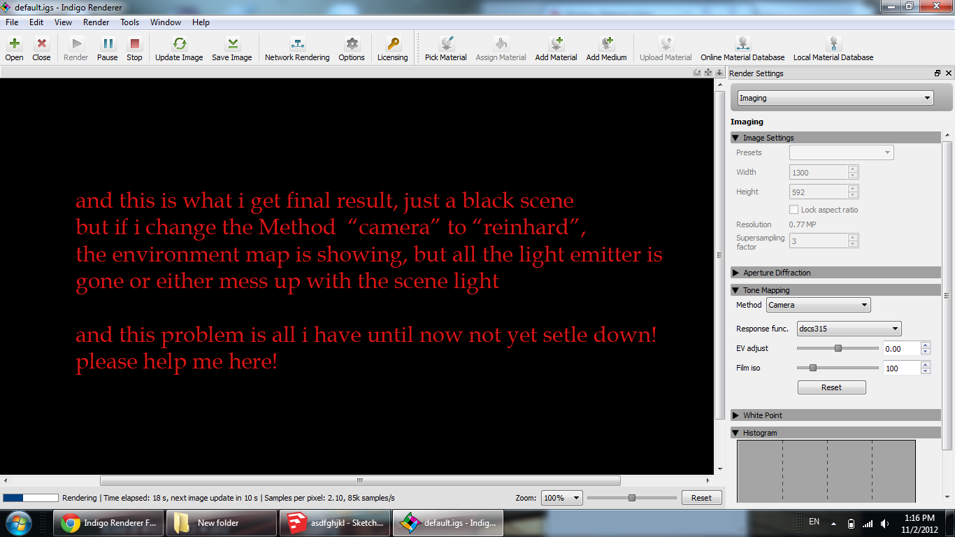

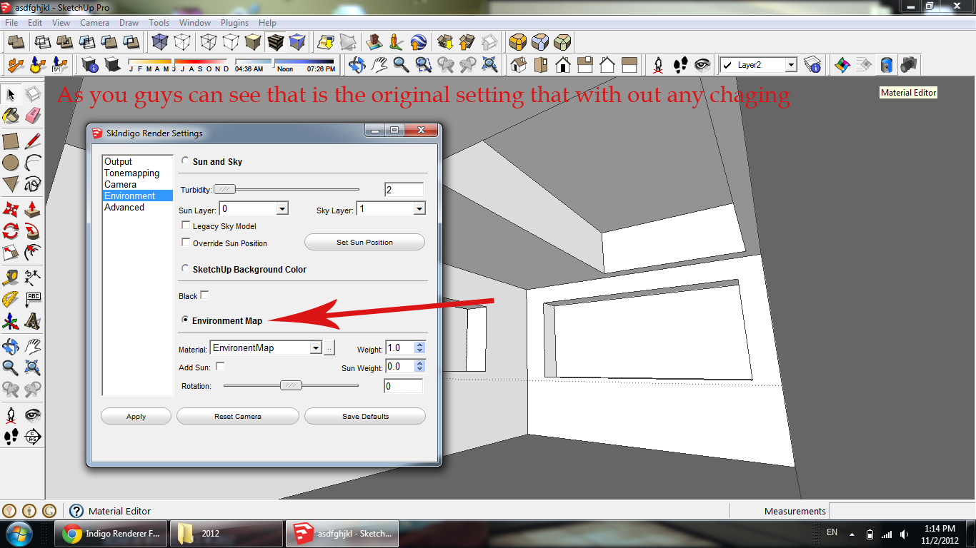

Environment Map can't set together with exit portal?
Re: Environment Map can't set together with exit portal?
Exact same Problem here!
Reinhard works
Camera does not
Env map is bright enouph, because without exit portal the scene is bright.
Exit portal + Sun also works.
It seems to be a bug, because in Sketchup 3.0.1.14 it still works perfect.
Thanks for your help!
Reinhard works
Camera does not

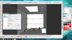

Ok, i upload a new scene sharing with all of you guys, see what is wrong from me, TQ!

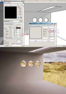

Don't use emission scale for EnvMaps together with EPs.williamhhf wrote:Ok, i upload a new scene sharing with all of you guys, see what is wrong from me, TQ!
Using Exit Portals afaik maps the outside emitter on the EP mesh so emission scale becomes effected.
Simply use Base emission with uniform with a a value of around 200.000, that should work
To Zom-B
im not really get it, i try what u told, but still cant see any change!
will be very appreciate if u have any photo guide, thx!

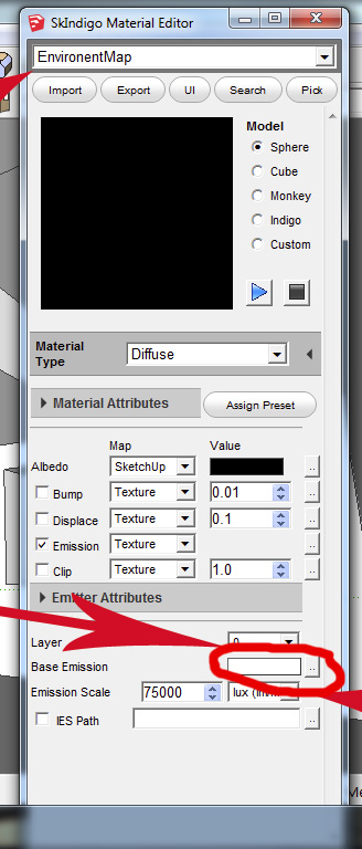

you need to deactivate emission scale and set Base emission to uniform with value of 100k. Should be possible in the marked area.
I'm have no clue about Skindigo so I only can tell about features that are Indigo supported... I hope they are also for the exporter...
To Zom-B
Im so sorry, after i try all you told from your photo guide, still nothing happen, is blank!
Thx anyway for the help!
wish some one out there have any idea to deal with this problem!

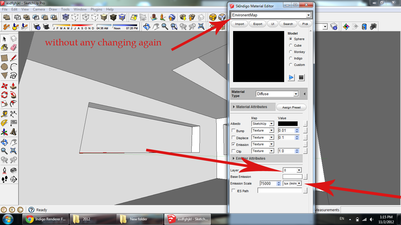

If the same scene is showing with reinhard tonemapping, and not showing in camera tonemapping this is clearly an exposure issue. Your EPs seem to work fairly good.
Dealing with EXR maps can be VERY tricky in Indigo, because realscale values go somehow to hell
First thing, try disabling the emitters for a while (just not to mess around with too many variables): you'll re-add them later. Then, change the emission scale value to a ridiculous value such as 10.000.000 (try not to change the camera parameters in the first place: btw, before shooting up the material values, you should play a little with EV value, ISO and shutterspeed in order get aligned with a photographer's kind of approach..).
See what happens, you should be able to see something.
You have to change the scale value for the environment emission map texture to a high value (in my example: 100.000.000). After this, you can fine tune with the exposure value in the Indigo GUI...
