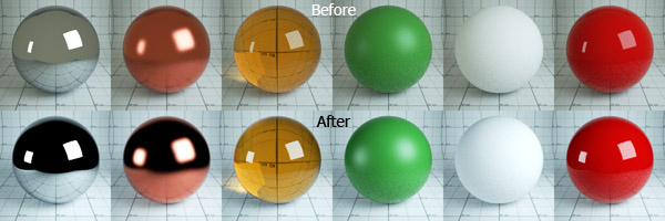

Not biggie, but it annoys me always when I install new Skindigo. I manually change preview scenes to get nice studio environment. Default scenes are a bit too uniformly lit, but I think it's better to see materials in dark environment with two light sources. This way I see shades and reflections better. There is also more contrast then.
Only thing to do is open preview_studio.igs in text editor and remove all from:
<!-- *** cube surrounding the scene (defined as mesh emitter too) *** to the end. Leave only last line: </scenedata>

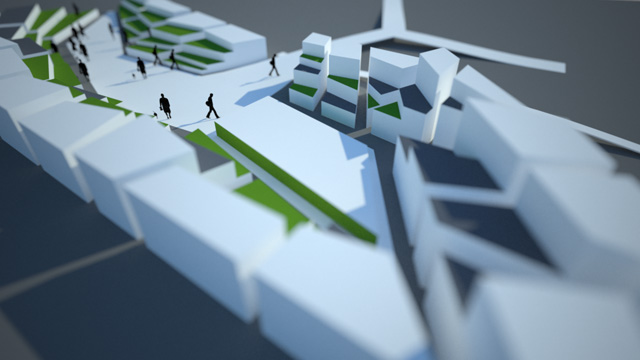

Oh, and I almost forgot. Is it possible to have option under Render Settings to change world scale. Sometimes its easier to model in bigger or smaller proportions than result should be. For example I'd like to render some basic architectural volumes as maquettes (nice blurry DOF), but it's easier to model as real sized buildings.
Right now I have to scale whole scene down with tape tool and position my cameras again and get into every component and scale them one by one.
