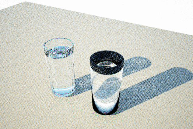

Ok... I am doing something wrong... perhaps someone can help. I attached a SketchUp model and my rendering of a glass of water which I did according to the specs in the Technique Manual. I used 2 different materials for the Glass and Water, applied the presets in Indigo (Water and Glass accordingly) and it clearly is not working.
HELP!!!

Post by snorky » Sat May 29, 2010 10:54 am
a storm in a teacup!
hehehehe
turn off soften edge from glass!

Post by cholme@me.com » Sun May 30, 2010 3:58 am
THANK YOU!!! I didn't think of that.
