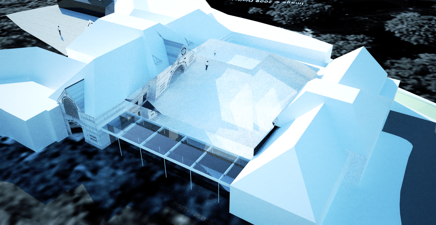

Maybe "Tonemap" settings.
In blender i have to set sunlight angle to get diferent colors (sky atmosphere colour + light intensity). White object will reflect atmosphere colour (surroundings) quite intensely.
In this example my house is in blue box, the walls are white.
