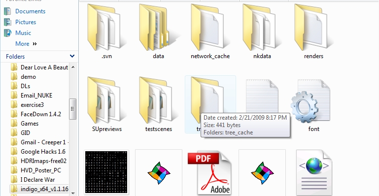

Post by neo0. » Sun Feb 22, 2009 4:18 pm
Are the 1.1.5 preview scenes different from these? They're don't seem to be working.
EDIT : I checked the download link for the 1.1.5 preview scenes, and it's says no such link exists. :( If I
EDIT2 : Now using indigo v1.1.6 and the mathching version of skindigo but the previews dont work.. It just gives me a little "could not load" image.

Post by neo0. » Sun Feb 22, 2009 6:02 pm
Well, here you go. I can't figure out what i did wrong.

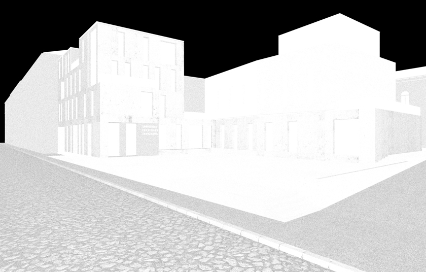

Post by Pibuz » Wed Apr 01, 2009 8:49 pm
Hi all! Hi whaat!
I'm here simply to report that the ALPHA MAP feature in this 1.1.16 unstable version isn't working like it is supposed to :D
The sky renders black and that's all right, but the walls aren't plain white: they seem to feel the effect of sun's direct shadows and of bumps maps.
Just a report here, nobody to blame for we know it is a beta version.
wrong alpha.jpg (210.39 KiB) Viewed 6031 times
