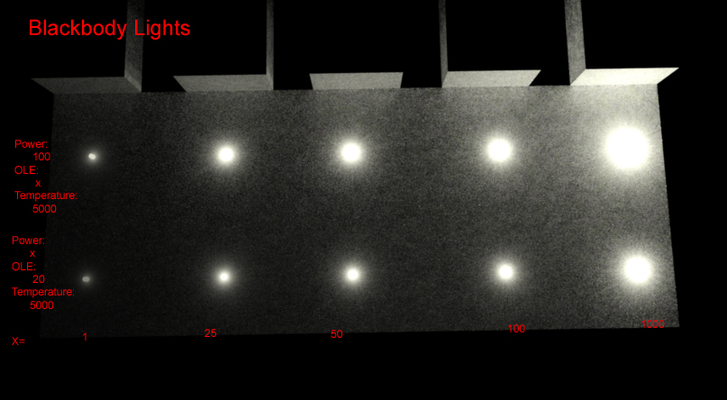

So... I gain I'm up late working/learning this kick a$$ addon to sketchup which has allowed me to have a nice sandblasted glass surface within my landscape. Now I'm trying to make the night shots (requirement of the design comp.) and as I adjusted the sittings the light seamed like they get brighter. So i changed the size of the light bulb (scaling it down by good 10 times) and still is seamed to get brighter. So I deleted a few lights and a bit brighter still.
I was using a blackbody light with the settings of power 5 and OAE of 5 and reduced both to .1 or lower. As I understand by decearsing the power it will decrease the light of "bulb". you can have the same effect by decreaseing the OAE? As I was trying to learn the lights i created this chart for my reference, but it did not help me at all. :twisted:
So any thoughts on how to get the lights working the way they should?
I look forward to your responses.
Thanks.
-Post-
the quick test I did to help me with the lights
light comparision copy.jpg (173.58 KiB) Viewed 9164 times

Your tonemapping is negating your light power changes - change to camera or linear tonemapping.

Post by Post » Fri Aug 01, 2008 1:01 pm
Thanks that works Never know that skindigo had an auto exposure.
