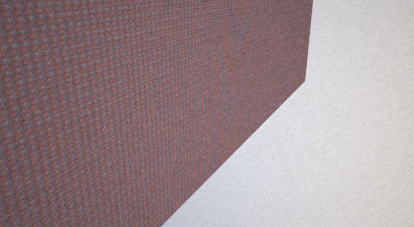

So, I have been have a bit of material scale problems too. I have attached two images to this post that highlight the problem. First I created 1m by 1m squares in sketchup and created a blend material (far left) out of the materials to the right. Then I applied the material over the componet a box about 1 or 2 meters in size (bottom image) and the scaling was very wrong. But, when I applied the material from within the componet it was the correct scaling. All parts was within the same file. Any Ideas on this?
Thanks
-Post-
Square box componet from the same file as above and about the same size. If you notice the material is about 1000 times smaller then what it should be.
The material to the far left is what the material below should look like
