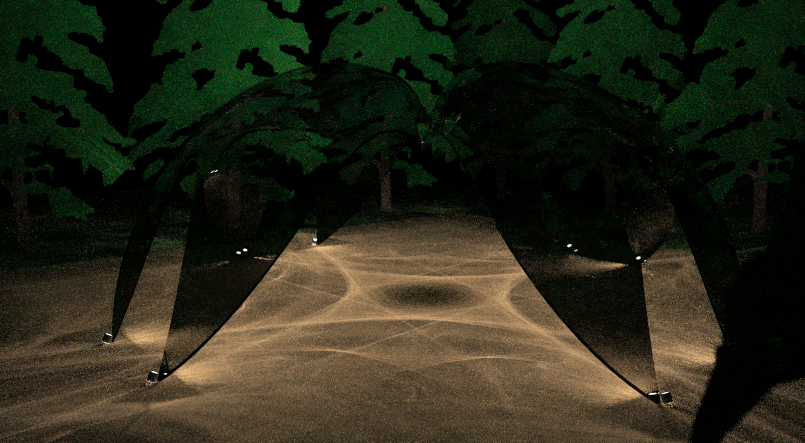

So i have created a glass bubble like shelter, playing with the ffd-ruby for Sk. Then added a glass matter to the shelter. I loved the rendered image! Indigo adds the "air" into the sketchup image that i have been looking for. Next, I placed a few lights at the "leg" hoping for some reflection.. but never got them.
Does any one know how to get the lights to bounce off the glass? Do i have to change the matter, or matter specs, or the angle of the light to the leg?
Glass shelter at night
Glass shelter at day

Ah well, that's a usual problem: The sky in the background actually is glazing bright. You need to pump up the lights' intensities so that you're able to see them at bright day ;)
And I'm not sure but I think, the lights' angles aren't perfect for reflections... Changing the camera angle as well as the angle of the spots might help with reflections a bit more ;)

Nice caustics !
Post by Kram1032 » Tue May 27, 2008 10:05 am
lol I see xD
So you never intended to do daylight + spotligtht at once? ^^

Yes the caustics rock on that second render.

Sorry, as I'm a newbie I have not learned all the terms --> Caustics is that the light refractions of the glass on the ground?
The first image was a test to see how the glass was going to rendering during the day with the reflections of the trees and sky. Was not looking for spots lights :shock: I still need to "play" a lot with indigo!!!

Yup, correct ;)
