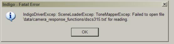

Yes thanks mate I'm underway!!!
I worked out that the Indigo folder was messed up to! Turned out to be a file decompressor I was using as a faster altrnative to widows native. It unzipped the folder and at the same time dragged everything out of the contained folders. Therefore absolutely nothing worked.
Absolutely nothing doesn't doesn't work now!

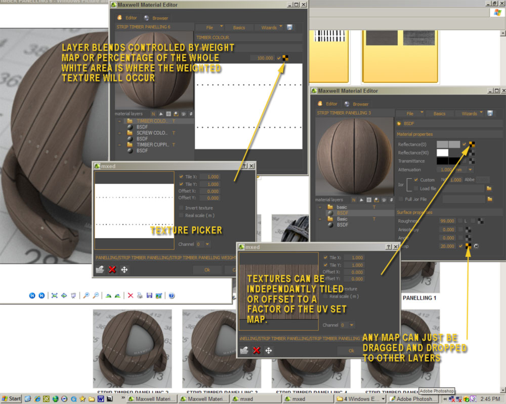

Mate here is a visual overview of the Maxwell material system that uses weight maps (greyscale) or proportions of the total to blend material layers.crojack wrote:Glad you got it working.Richard wrote:Yes thanks mate I'm underway!!!
As said to the other thread I think there is another workflow needed for blending materials but no ideas this end.
I'm certainly happy with much about Indigo, as to whether it becomes a big part of my work flow? _ I'd suggest so!
Can you tell how blending materials is done in Maxwell. I find it also difficult in Skindigo but can't think of another way to do it.
I wonder if maybe there were little mat thumbnails for each "layer" in a blended material? I'm just very visual and find it easier to keep track of things that way. Which is one reason I like Skindigo soo much!

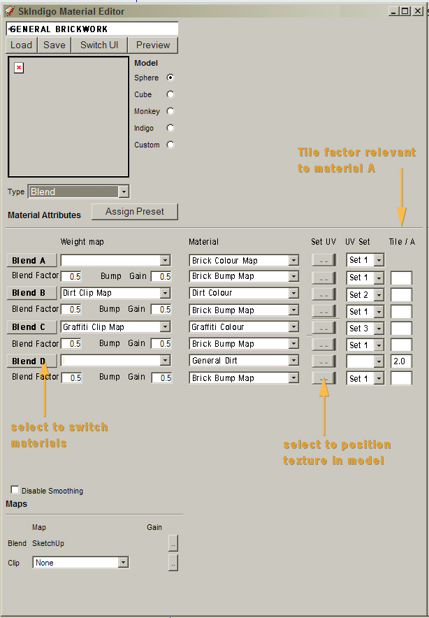

My suggestion (though rough) toward the blended material editor. Though I think this also needs more consideration.
I think it not only needs to consider maps but materials.
It would be nice to be able to use clip maps to allow indigo materials to be blended, for example a building facade (say for context buildings surrounding your scene) you could clipout brickwork, windows, frames etc from one map placed to a plane.
I must say though that with all the current material options the maps have to be included in the SU materials browser.
I can foresee major problems with this in some SU models. If we have a model with 50 materials and some of these are well blended materials all hell could break loose in the material browser!

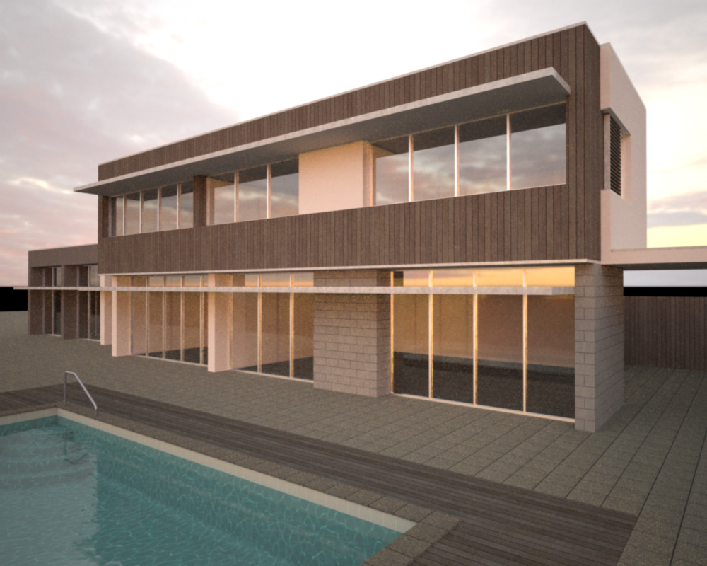

My first test render!
No post processing! Had to use auto exposure as a few trials with camera settings by trial and error was making me mad!
Very low detail rough model, just for test!
Lighting with exr. Hey is HDRI yet supported??
Aluminium window frames look crap. Fake cautics on the pool bottom needed lower contrast on image map, water surface I think came out ok. Tiles need less bump (used just the colour map) and blended material to dirty up and reduce repeat.
Thin Glass material works well IMO.
Rotate environment great inclusion Whaat!!!! Lift and drop next please!!

- If I want to use v1.0.8, i have the following files&folders structure:
\indigo_v0.9.10bkp (folder)
\indigo_v1.0.8 (folder)
C:\program files\Google\Google SketchUp 6\Plugins\SkIndigo09 (folder, v0.9)
C:\program files\Google\Google SketchUp 6\Plugins\SkIndigo (folder, v1.0.8 )
C:\program files\Google\Google SketchUp 6\Plugins\SkIndigo_09.rbkp
C:\program files\Google\Google SketchUp 6\Plugins\SkIndigo_1_0_8.rb
C:\program files\Google\Google SketchUp 6\Plugins\indigo_1_0_8path.txt
C:\program files\Google\Google SketchUp 6\Plugins\indigo_09_path.txt
This way, it does not find indigo_v1.0.8 folder when i run skindigo_v0.9
(oh, & i'm reading the manual. In fact,i need a fast & deep course on rendering. Some comments on this will come soon
gautxori,
You are very confused about a lot of issues regarding paths. I don't have time to explain everything right now. However, the best way to check what Indigo version that SkIndigo is using is to go the the 'About Indigo' menu item when Indigo launches.
Even if your scene file path is in the Indigo v1.0.8 folder, it doesn't mean that you are using Indigo 1.0.8. This is because SkIndigo saves the last path that you used to export your SU file and uses it again next time to render your scene. To change this path, use 'Export Scene as.....'
Thanks for the screenshots Richard.
That is somewhat what I was thinking as to how it works. I like your little mockup. But, I don't understand the wight map aspect of it. Is that the "main" material that all the other materials become a part of? not sure if that makes sense.
nice render, I use the basic color map as a bump quite often unless I need something really specific. But just to give a material a little texture, I think it works great.
