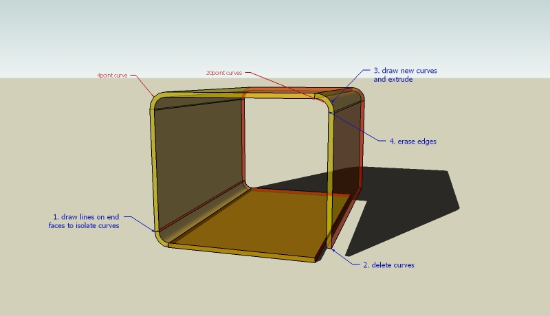

At risk of stating something obvious, depending on at what stage your model is at, the number of segments in a curve can be changed. See attached.
If the curve is 'married' to some other geometry, then obviously cant change it. So yes, it does help to plan in advance!..:)
xrok1
Posts: 287
Post by xrok1 » Fri Aug 24, 2007 9:02 am
try this!
curve resolution.jpg (80.72 KiB) Viewed 4320 times

yeah I already changed the number of segments, but in hindsight it didn't work because the structure is connected to the wall :)
I guess if I pull it out and put it on a separate layer then I can work on it.
Still how to bevel the front edges of the cubicle? tricky as the surface is curved...
