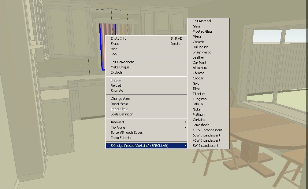

I thought I would release SkIndigo 0.7test5 even though Indigo 0.7test6 just got released today. You can expect SkIndigo 0.7test6 to be released before the end of the weekend. I will also release a SkIndigo tutorial within a few days. However, I will post the updated "How To" list below. This can also be found in the "About SkIndigo" menu item.

Important: You can no longer adjust the tonemapping settings in the exporter. This is now done with the Indigo Tonemapper GUI "Violet" which is available at this link http://www2.indigorenderer.com/joomla/f ... php?t=1332

#Added: context menu to apply material presets and quick export

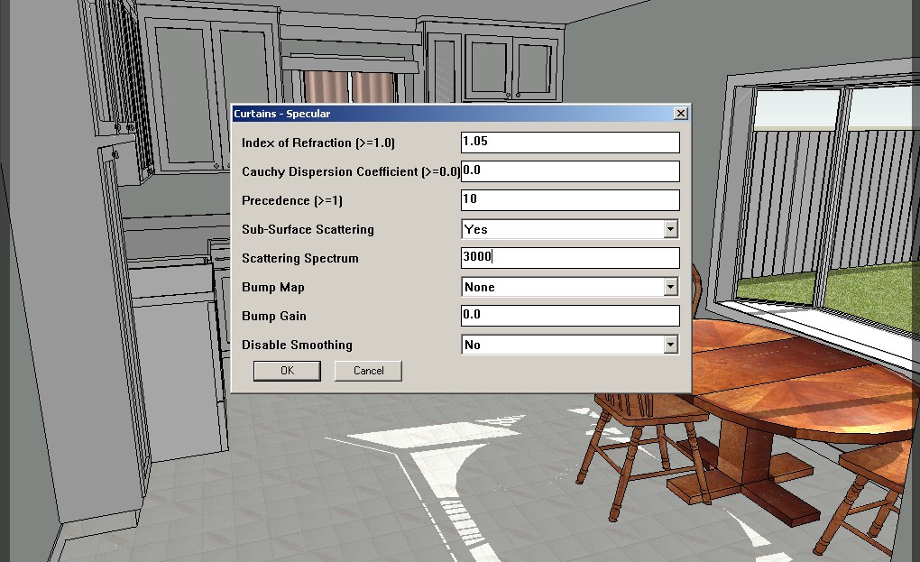

Use Sub-surface scattering
1. Enable transparency in Sketchup material settings using the opacity slider
2. Set the material type to SPECULAR
3. The opacity slider will change the amount of RGB absorptivity. Set to 0 for no absorptivity
4. Enable SSS with the material editor
5. Input the Uniform scattering coefficient or the 3 RGB scattering coefficients separated by spaces
4. SPECULAR materials should have thickness to render properly.
