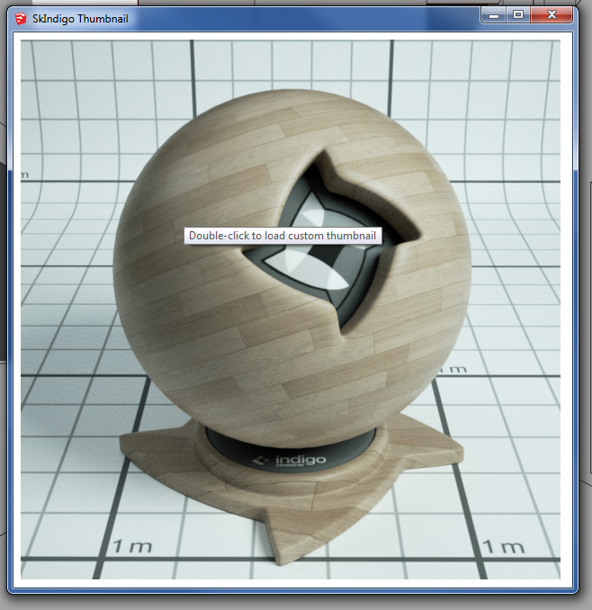

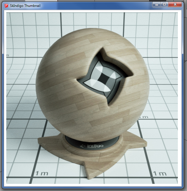

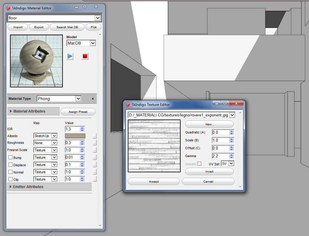

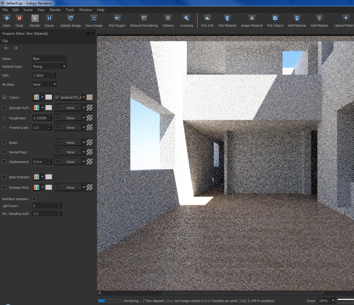

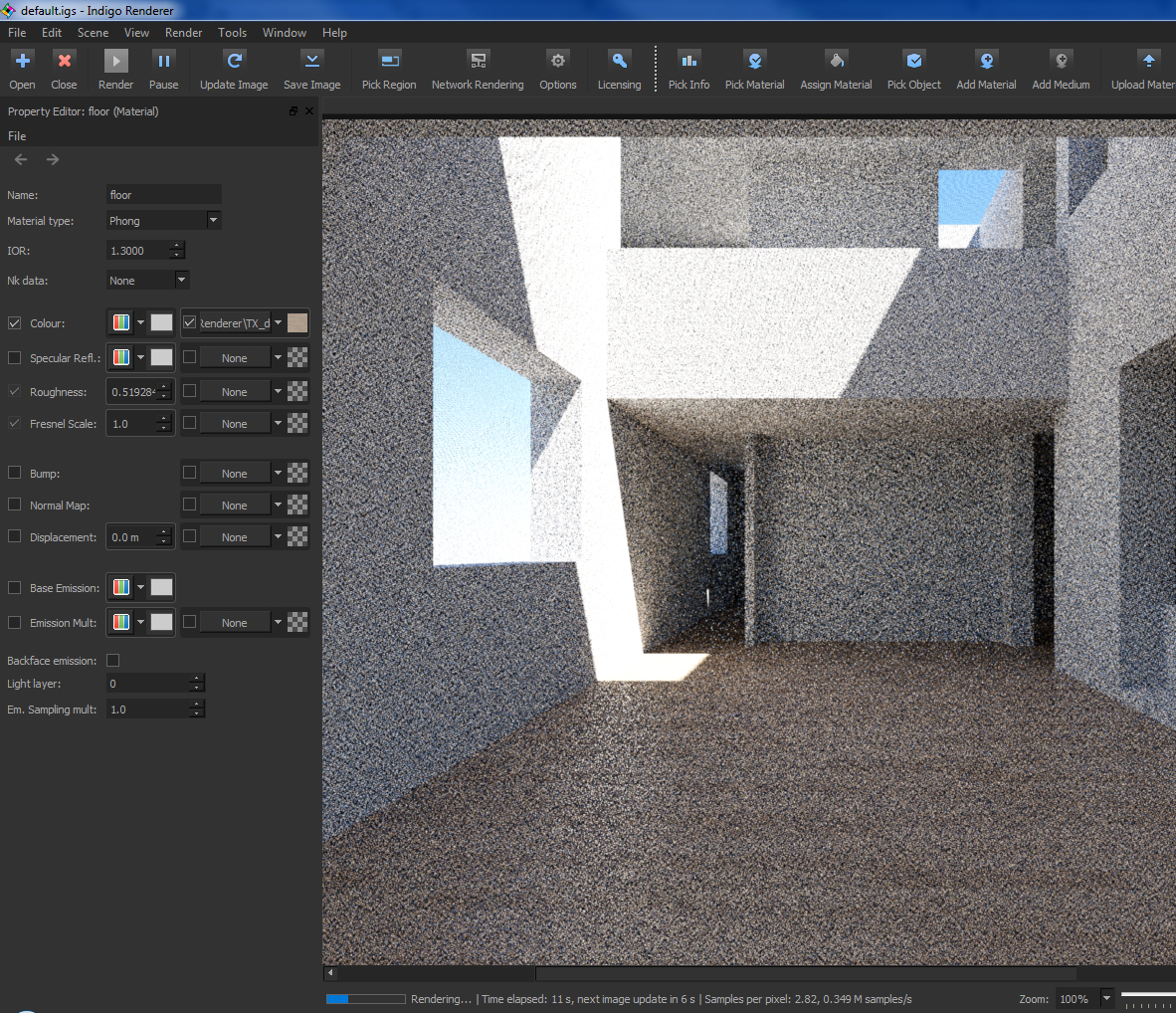

Re: SkIndigo 4.0.50.1
Attached two skindigo tests of mat preview, with and without Fresnel Scale map.
I get no difference in the mat preview, and Indigo doesn't have maps either.
Also, the roughness numeric parameter receinved by Indigo doesn't seem to be related to the one set inside SketchUp: should it?
(Skindigo value for roughness was 0.3, in Indigo it was translated into about 0.52, is that behaviour correct?)
Thanks for bug report, fresnel scale maps exporting was busted for phong, fixed: https://www.indigorenderer.com/forum/vi ... 17&t=14375Pibuz wrote:Attached two skindigo tests of mat preview, with and without Fresnel Scale map.
Also, the roughness numeric parameter receinved by Indigo doesn't seem to be related to the one set inside SketchUp: should it?(Skindigo value for roughness was 0.3, in Indigo it was translated into about 0.52, is that behaviour correct?)
Regarding the roughness value: If the scene was last saved with a SkIndigo version that was using exponent, the old exponent will be exported. If you change the roughness value, the updated value should be exported.
