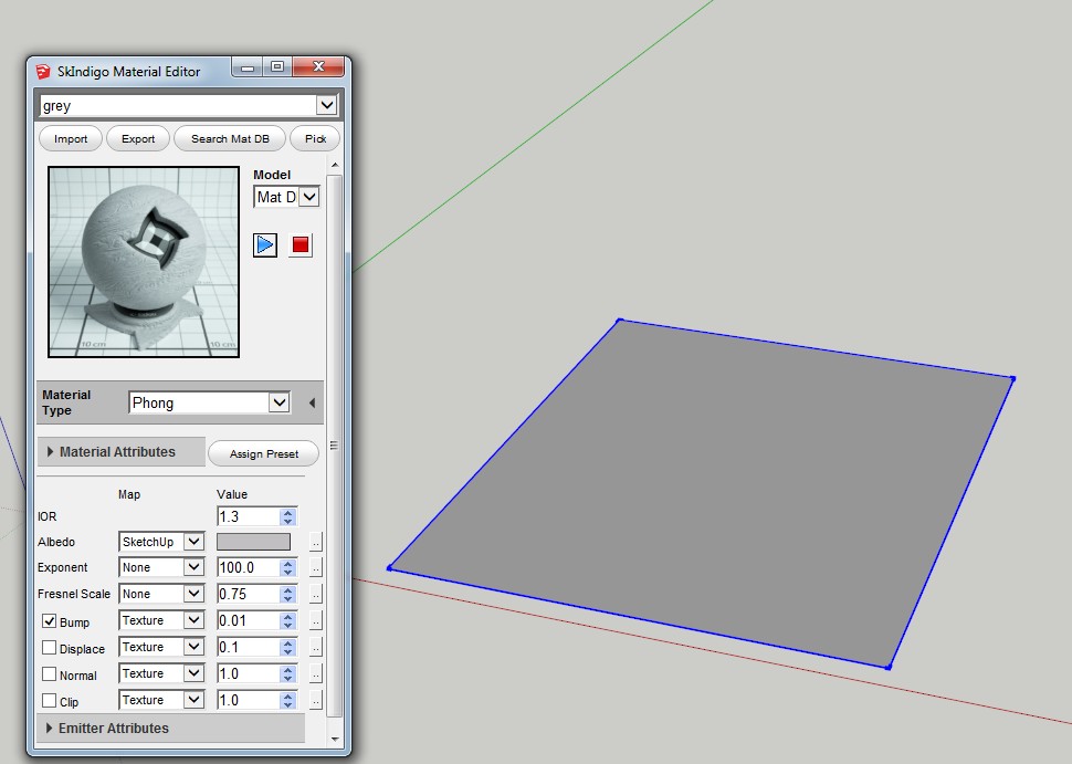

Hi all, I have a problem with bumb mapping within skindigo. When I set up bump map for active mesh, in material editor preview I can see the aplied bump. But when I try to render the scene, I get strange result (see the picture)...it is a long time since I did the bump map, so maybe I forgot some studip simple thing :)
result?

Just set your bump image as material texture in SketchUp. As soon as there is a texture, SketchUp will generate UV coordinates.

Cocash: apply the bump texture as the diffuse SketchUp material texture AND the same texture as the bump map texture in SkIndigo (like you already did).
Then, in the SkIndigo mat panel, change the Albedo scrolldown input from "sketchup" to "None" and set a RGB value (which will be used instead of the sketchup texture).
