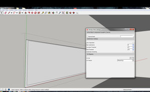

I am new to exit portals and can't seem to figure out how they work. I don't see the option to check like in the simple tutorial found here http://www.indigorenderer.com/documenta ... s-sketchup
Check out my screen shot and see if you know what I'm doing incorrectly, thanks in advance.

also I'm using sketchup make 2015 and indigo 3.8.25
my RT license is at home and I'm at work

Assigning Exit Portals as a mesh attribute was only a short lived thing... It is now (as it was before) a material attribute. Just paint all your exit portal with the same material in SketchUp and then chose 'exit portal' in the material type drop down menu. Just make sure your exit portal are facing into the scene, i.e. you can see the painted side in your camera shot.
These tutorials should either be updated or removed if they are providing incorrect information.
