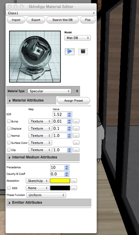

So I can't seem to find the "Arch Glass" check box under the Specular Option.
I am running SkIndigo 3.6.25.5
Any Ideas?
Any Ideas?
Re: Help With Rendering Basic Knowledge
Arch glass option isn't in SkIndigo yet, as it is quite new.

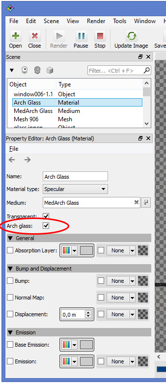

I clearly explained that you need to tick it in the Render GUI mate, by hand... then it works!PushCreative wrote:Very unfortunate, any expected date that that would be available in a beta?
How do some of these pros achieve such a scene now then? When using an Exit Portal with Internal Glass in the scene?
You can bet I denoise the hell out of my animationsPushCreative wrote:Is it just typical to clean up the artifacts up in post processing?
Even for still images I render in 200% of final scene size needed, then denoise, and reduce size down to 100%, so I get rid of noise and keep details
Oh my bad!
I just started to re-render it with Arch Glass on and I can instantly see the difference!
Ok now we're talking! Thanks Zom-B you've been a big help
