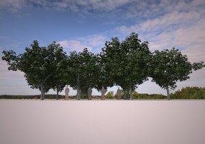

Definitely a +1 for dummy components.
Here are some examples using a high poly tree, even one of these trees in a Sketchup scene destroys performance to the point where I can't even work. Using dummies I can still rotate and pan etc happily with multiple copies and let my Derricks have a lovely bit of shade :)
I use dummies for high poly cars and trees. You can make them larger of smaller and rotate etc just by rotating and scaling the dummy component. I make my dummies see through so I can still place trees etc and see whats behind and under.
You still get the shadows of the tree component too.
