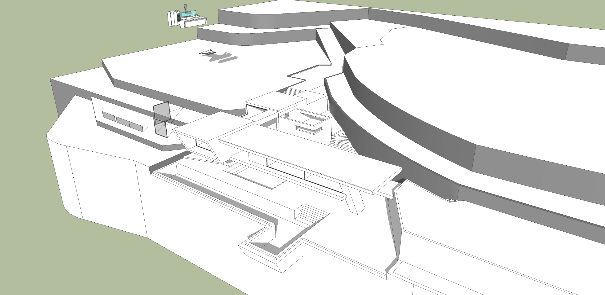

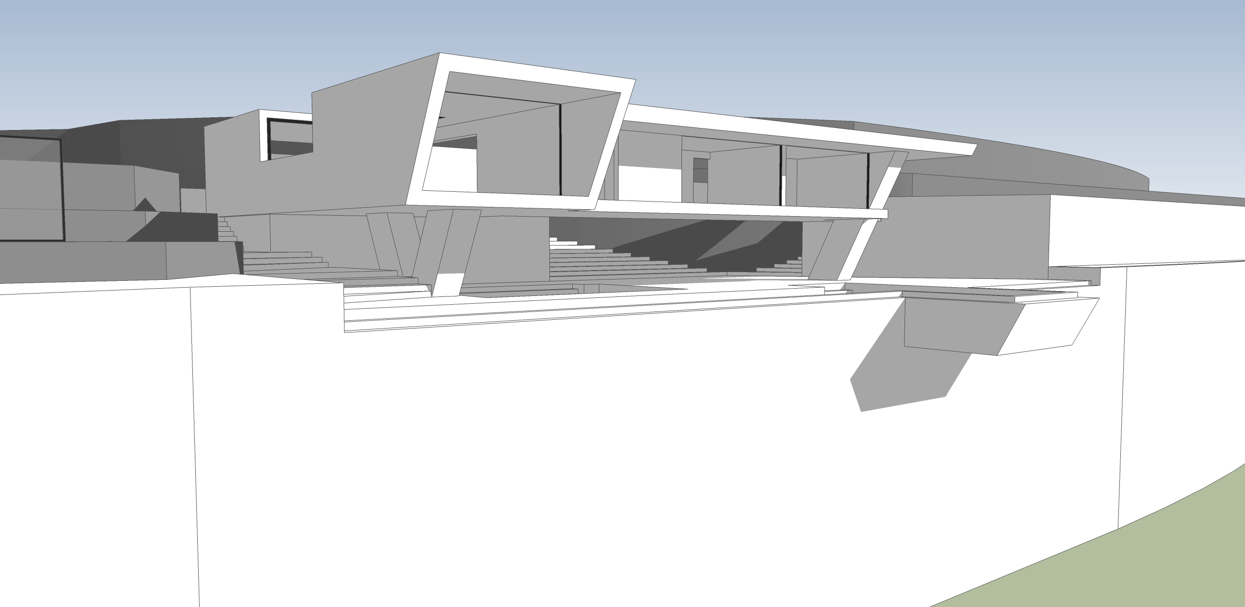

This is a project I am working on for a villa in Cyprus. The villa is on a cliff on a mountain and as you can see there are alot of levels. I noticed on the net that people only render specific rooms like a movie set from a film.
Do I choose materials for the whole model or do I only choose materials for the actual scene I am about to render?
How long do I render for? What is a good time period?

Personally I only model/texture what will be in the final render. All of my building exteriors are like old film sets, those areas facing the camera are modeled and textured, anything else is just a prop to set up the main scene, unless it forms part of a reflection. There seems to be little point in spending time modelling and texturing elements that will never be seen. If you're going for a stylised look or have time issues then in the past I've combined styles, so the main focal point is rendered properly, and surrounding areas are left white to give the impression of context, but not to draw focus away from what you want the render to be about. if that makes sense.
In terms of render time, it will depend hugely on the scene you're rendering, what materials you have in there, how much lighting etc etc...Scenes with lots of lights (and light layers), multiple shiny surfaces etc will take longer to render smooth than a scene lit by a single light. It will also depend on what tracing method you're using (PT, MLT, etc) and if you have GPU acceleration switched on (only possible with PT I believe). Lots of factors.
So the only way to find out is to try! Hit that render button and see what happens. Post your results here and we can help/advise if needed. Good luck

That's a big project, which you can learn a lot from. From my experience, post processing can never save a bad render (and it's way more time consuming). We've all been in your shoes - but the only way to learn rendering is by trying and experimenting. Browsing the forum to get inspired helps too, of course.

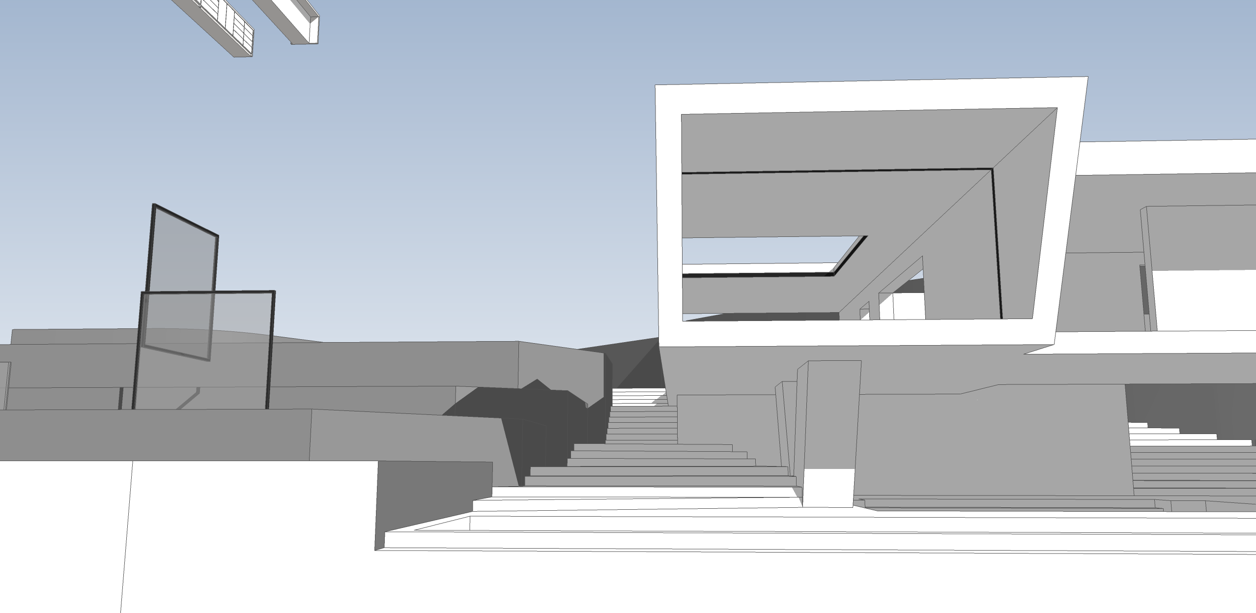

Yes, it is a big project. I think I have bitten off more than I can chew. I noticed people use alot of trees on the edges of their renders to disguise things. But, I want to portray the view.... which is the whole point behind the villa. I went to Cyprus 3 years ago to build 5 villas on 5 plots of land. I got ditched by the client for a younger, local architect who new what they were doing better than me. I just want to use this to show what was potentially possible with the site. Back then I did everything by hand. The architect introduced me to Sketchup and I ditched my pens and drawing board for software. So good things come from disappointments. Sometimes

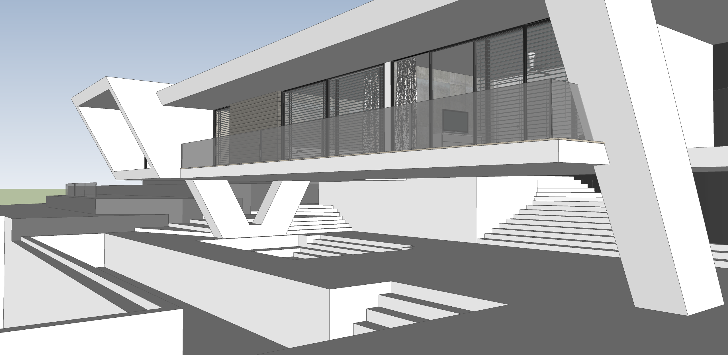

This is where I am up to at the moment.

Good start and keep that motivation.
The closer to the camera the better textures and models you need. I personally like when everything is high quality but you have to learn the 'exterior linked component' feature because sketchup doesn't handle large amount of polys.
If you want interior shots I would do it in separate skp files.
Any fotoreferences you would like to share with us?

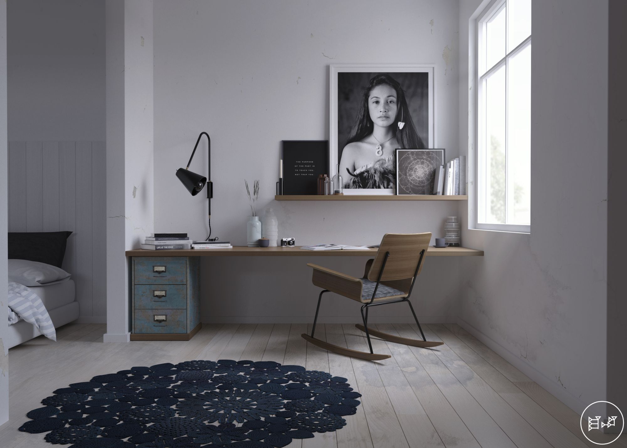

This is a good reference image for me for an interior shot. I really like it.

I had a look at the reference to Pibuz's interior with Sketchup. Very nice. I really like the floor against the dark table. I am always trying new software to see what works.... I always go back to Sketchup though for one big reason.... the measuring tape tool. It's unique to SU and I cannot live without it.
I only have one thing to say about the image.... the block print wallpaper. I would have used it less and made the print bigger. I only say this because I used exactly the same print for a project in London and these designs always work big and bold. I used it in dark grey. But you have to use such prints sparingly or it gets too busy.
Where did you get the floor from?
Pibuz... you mentioned Fluidimporter.... and see if it helps with the 3Ds imports.
I have enclosed an elevation of how I used the block wallpaper.

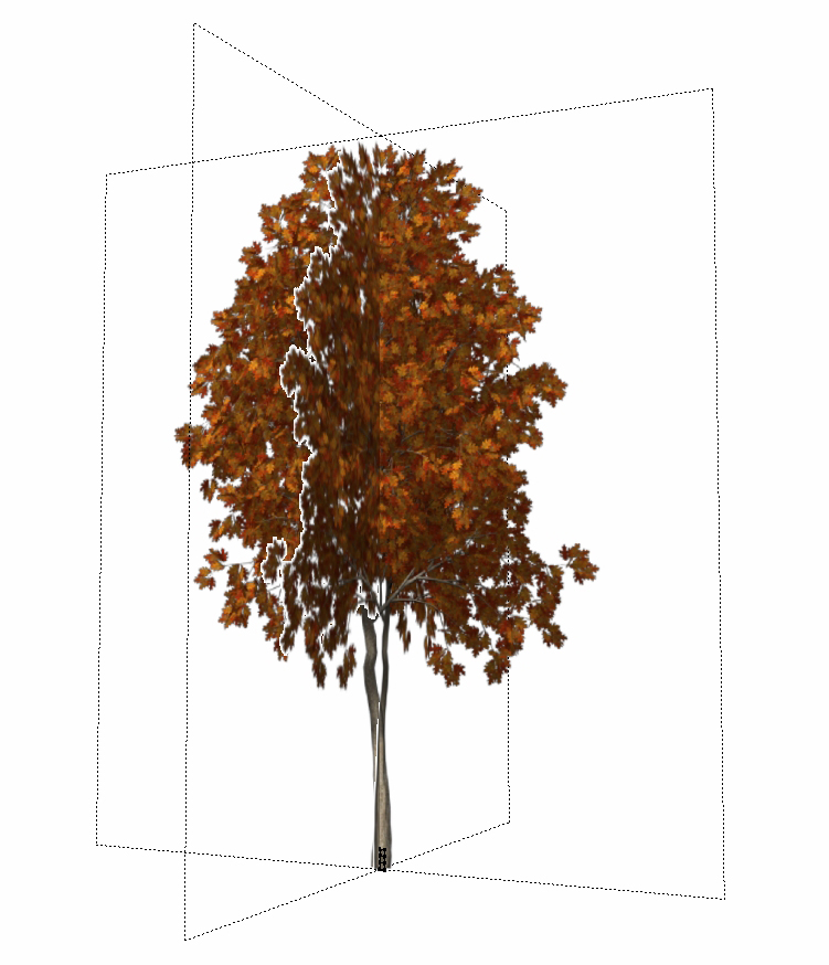

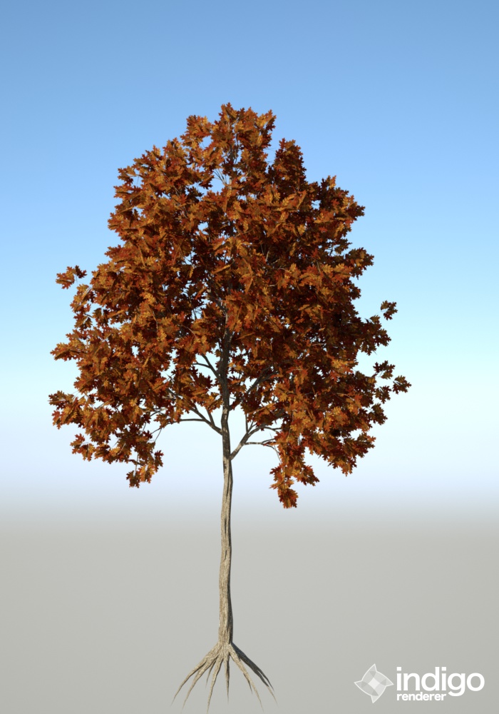

Re: How to render?
Honestly I always use ext meshes now, in .obj format. They are so easy to use once you get the hang of it. I create a 2d version of the tree from .png images, which I use within skecthup and then link them to the hi poly .obj model. If you look on the Xfrog website, they quite often have free 'sample' models of a lot of good plants & trees which you can download.
Have a look at Whaat's great tutorial videos on Youtube... https://www.youtube.com/watch?v=nYhng66TEW4
If you really don't want to use 3d trees then if you can get a decent hi res .png of a tree with all the background properly removed you will get OK shadows. (but just Ok, there really is no substitute for the 'real' thing IMHO)

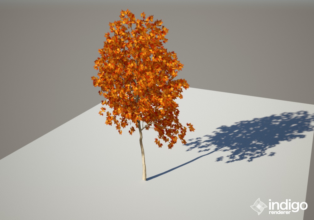

Re: How to render?
Here's an example of the shadows from a 2d png of the same tree. The image is low res, so the tree doen't look good, but you get the idea.
