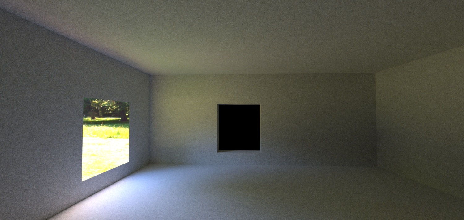

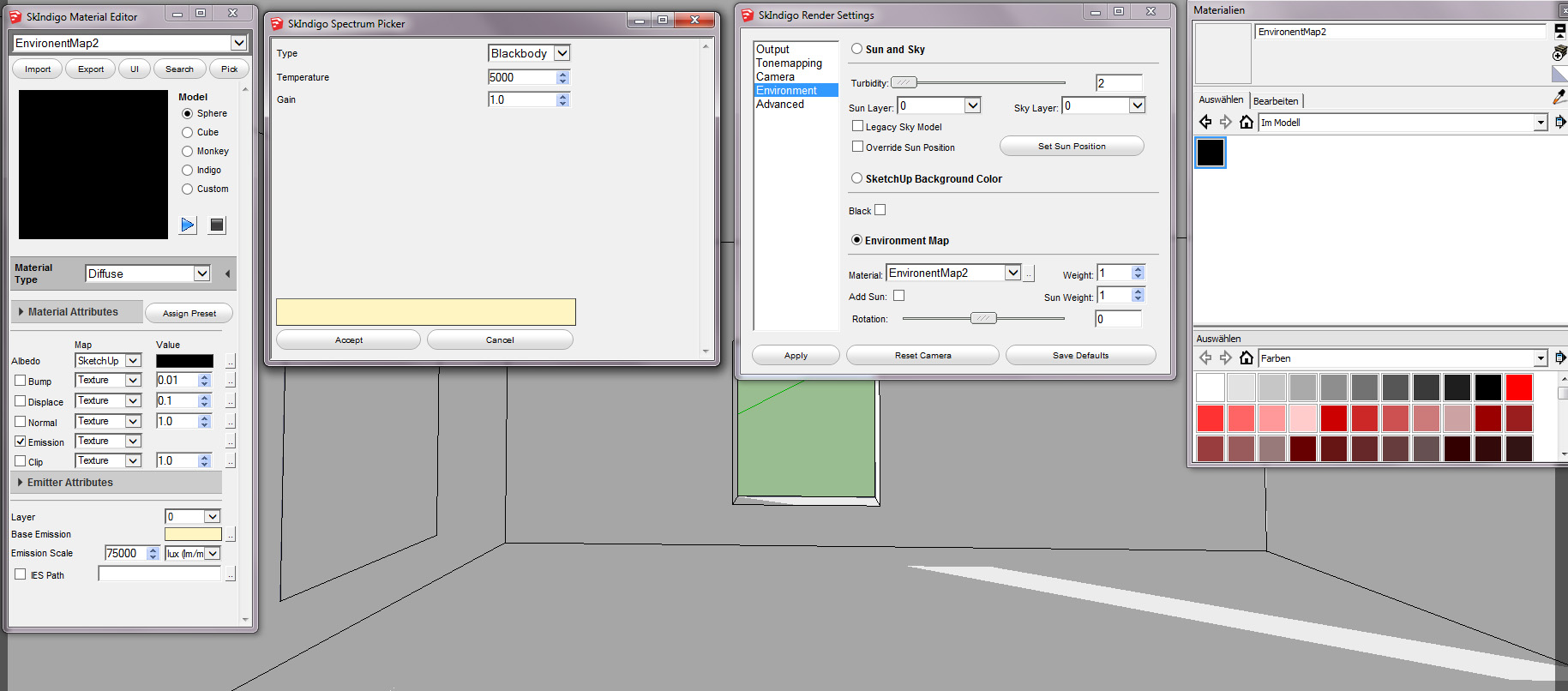

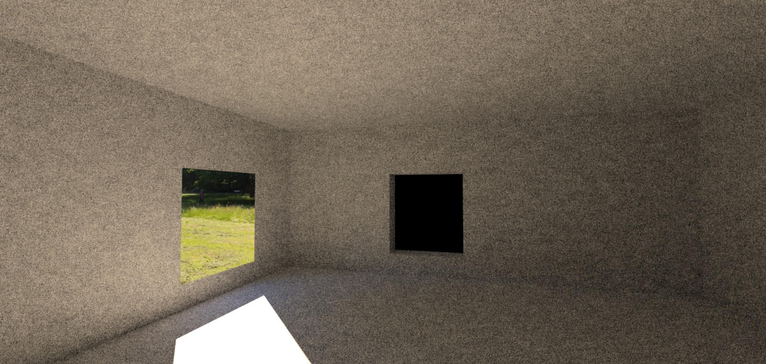

Post by lape » Fri Jun 14, 2013 4:11 am
I just tried to render a scene using exit portals. I also used an environment map. Without exit portals everything is fine, and my scene renders like it should. But when I use exit portals, the environment map turns black. I already read some posts from Pibuz who seemed to have the same problem with Skindigo http://www.indigorenderer.com/forum/vie ... 0&start=75) but whatever values I use for sun, environment map and emission: no chance :(
I also tried to export the scene and change the settings for the background settings via the property editor, but whenver I try to change anything, Indigo crashes.
What seems to work: Export the scene without environment map, and then use the property editor to load a new exr. If I do this, I can change all settings for the exr, but now I have no button to add the sun???
Any help?

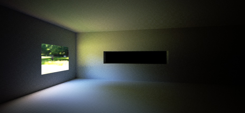

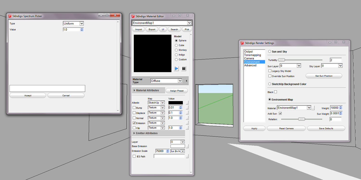

lape
Posts: 241
Re: problem with environment map and exit portals
Post by lape » Sat Jun 15, 2013 7:36 pm
OnoSendai wrote:Hi Lape,
Is the problem occurring when you tick the 'Add Sun' checkbox in the SketchUp environment map settings?
No, the problem also occurs if I only use the environment map for lighting. And it doesn't matter if I use "blackbody" or "uniform" for the emission. As soon as exit portals are active, environment map renders black. I already tried different exr files, but the result stays the same :cry:

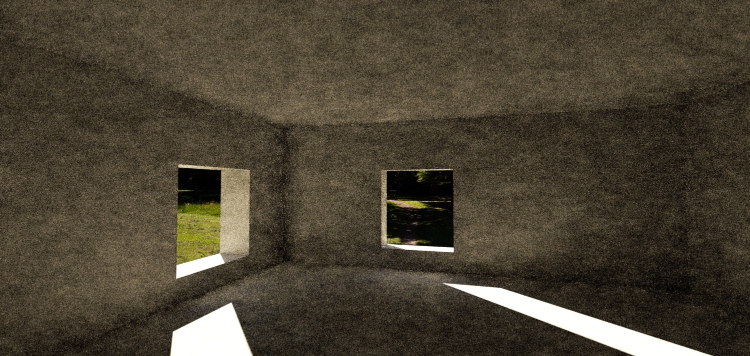

Post by lape » Tue Jul 02, 2013 7:54 am
OnoSendai wrote:This should be fixed in 3.6.16: http://www.indigorenderer.com/forum/vie ... =1&t=12429
What I have done is make the exit portals use the emission scale from the background material.
So the background should now be the same brightness with and without exit portals.
Sorry, but I don't get it...I still get a black environment map. What am I doing wrong? This is driving me mad :?
I attached my simple Sketchup test model with exit portal and exr, perhaps somebody can try it and post a result with settings?
test ep.zip
(2.2 MiB) Downloaded 392 times

Post by dag » Tue Jul 02, 2013 4:35 pm
You need exit portals in both windows. Light only goes through exit portals if one is in the scene.
