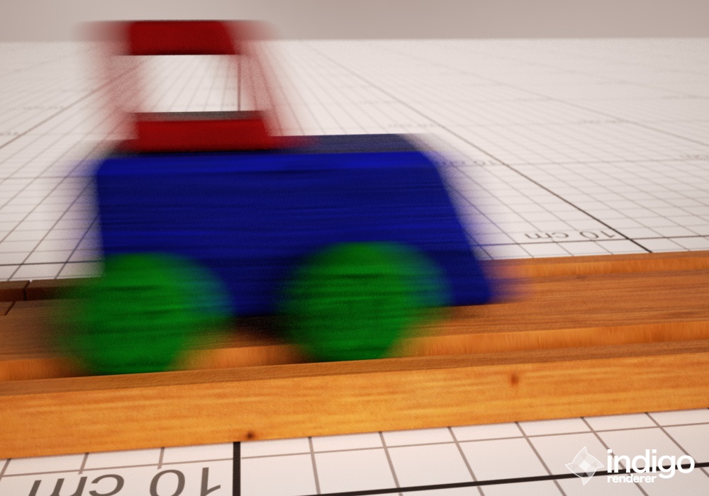

cotty
- Posts: 314
- Joined: Tue Aug 03, 2010 7:59 am
- Location: Germany
Post
by cotty » Sat Mar 03, 2012 7:28 am
I think there should not be a blurred area in front of the train because it hasn't been there?
- Posts: 7240
- Joined: Thu Nov 16, 2006 4:34 pm
- Location: Paris, France
Post
by CTZn » Sat Mar 03, 2012 7:34 am
it is exactly there at the end of the frame
On average the
e:occlusion of the background by the vehicle is centered over the whole shot, but during the
time of exposure the object is effectively travelling from one point to the other.
Having blur only at the back end is an artifact coming from comics !
cotty
- Posts: 314
- Location: Germany
Post
by cotty » Sat Mar 03, 2012 8:05 am
CTZn wrote:it is exactly there at the end of the frame
On average the
Then I have no bad conscience, to show another example...

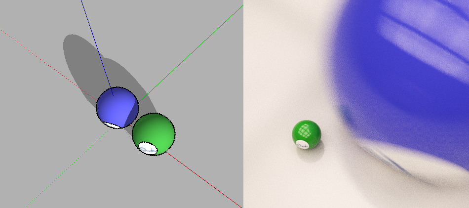

Post
by cotty » Fri Aug 17, 2012 2:05 am
I have noticed the error described
here again and because there is no manual instancing anymore, I am not able to get the right result. Any suggestions?
(I only moved the blue sphere along the red axis without rotation)
Whaat
- Posts: 1827
- Joined: Fri Dec 22, 2006 6:15 am
- Location: Canada
Post
by Whaat » Fri Aug 17, 2012 7:37 am
cotty wrote:I have noticed the error described
Hi cotty,
Make sure there are no nested groups or components inside the object that you are applying the motion blur to.
cotty
- Posts: 314
- Location: Germany
Post
by cotty » Fri Aug 17, 2012 8:05 am
Whaat wrote:
Hi cotty,
I think I have followed all the steps from the first post and the spheres are without subgroups...
I have attached the file for testing...
