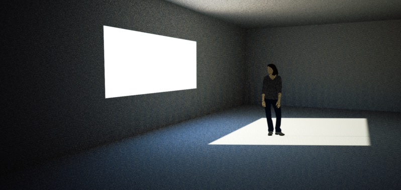

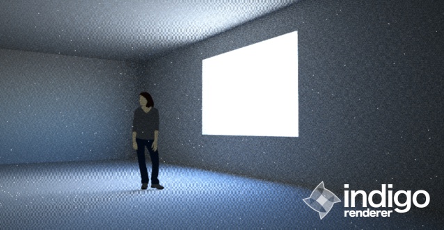

Hello everyone I have questions about Exit Portals.
First of all, I'm using latest Indigo and Skindigo versions. The Scene setup is; camera advantix 100, Bidir PT, no glass, it's just a simple test scene. I followed the Exit Portal tutorial step by step.
In first picture I used sun&sky environment, second one is done with Exit Portal.
EP was too dark so I used EV adjust to lighten it (third one).
Here's my question: where have my shadows gone?

This is a known limitation of Path Tracing with Exit Portals, they don't cope together. Path Tracing is forced on by Indigo whenever GPU acceleration is used.

I think that the main difference is that the newest SkIndigo has GPU acceleration on by default in the Advanced Render Settings. In this case, the GPU will use single path tracing (bad with EP's by nature), disregarding the Tracing Method setting !
The render from 3.0 uses bidir as default while the latest version is forcing GPU (path tracing) I think.

Wow you're right. GPU acceleration was on by default. I switched it off and now it's perfect.
