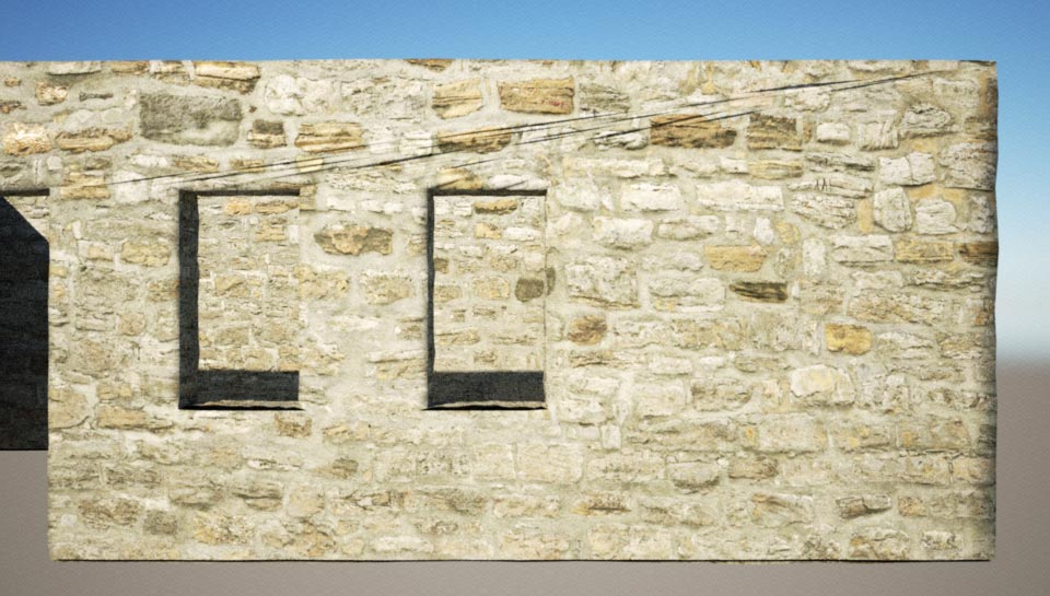

While smoothing and "welding" corners on a mesh with a displacement map, sometimes SketchUp gets some funny ideas as to how it should be done. See this image:
It seems to happen when the image that's getting smoothed gains complexity, ie more holes get punched it it. But not always. Here's a similar object that sketchup interpreted in a friendlier way.
Anyone have some guidelines for avoiding this problem?

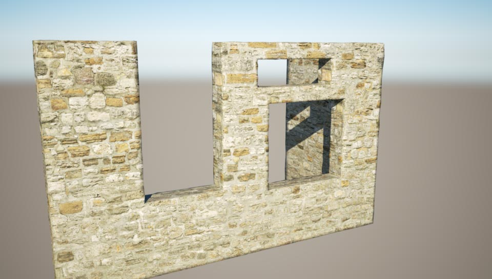

We briefly touched this once in another thread, but I thought it might be worth getting into.

The solution here, as you illustrated, is really the knife (line tool) to constrain triangulation. It may be counter-intuitive for a SU user but a clean mesh has often more edges than the volume requires.
Hint: Try not cleaning construction lines, or try to extrapolate lines from rectangles.
Lines should be intentionally added from the corners and around the openings, and generally to divide the wide, plain surfaces into square zones. Much like Qix.
More seriously there is this notion of "edgeloops", equivalent to splitting accross the whole surface for walls, wich is crucial for predictable subdivisions (and potentially absent from SU).
You can look for polygon topology images, topics and tutorials over the web for the best ways to add lines depending on the shapes you are dealing with (this one for instance).

The Qix example is perfect. Dividing these planes into several rectangles creates much more predictable subdivisions. Thanks CTZn!CTZn wrote:The solution here, as you illustrated, is really the knife (line tool) to constrain triangulation. It may be counter-intuitive for a SU user but a clean mesh has often more edges than the volume requires.

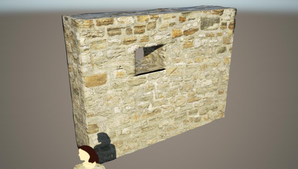

Here's a new funny little bug though. The edge on the bottom front of the hole in this wall is welded/smoothed but still seems to be popping a hole in the mesh. Any clues on this one?

I'm glad that you where able to enhance the resulting triangulation already !
Being just coplanar for edges is not satisfying the requirement to have them merging together, even though they are sharing the two same points (given two unique points, it is possible to have an arbitrary number of coplanar edges between). If you are however certain that they were effectively welded into one single smoothed edge, then you may want to make the scene available to Whaat.
Because coplanar edges are usually hard to detect (smoothing does the job best btw), it may be necessary to delete and rebuild all the surfaces in contact with both points. Implicitely you would then need to delete the points themselves.
Note that I am hereby ignorant about the specific tools SU is offering in order to detect and merge coplanar edges...

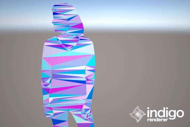

tip: to visualize the natives triangles from SU in Indigo, disable subdivisions and assign a diffuse material to the mesh. Then, in the Indigo's Property Editor for that material click Random Triangles Color down the material parameters (only iffuse materials have this option).
You will then clearly see wich parts of a surface need to be cut down in order to harmonize triangles sizes. This last step is important in order to get an homogeneous level of detail from displacement all over the object.
For instance a first step in the case above would be to add a line between the collar and crotch.
