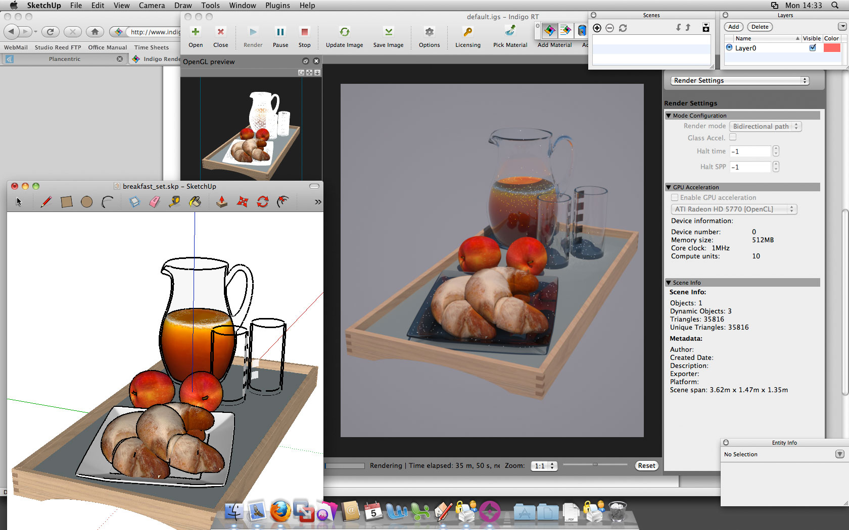

Dear All,
I am new to Indigo.
I have a model on sketchup, with textures that do not seem to pass into Indigo RT. I have no clue what is the problem, plese see attached image.
You can get the original Sketchup file (for free) at: http://www.designconnected.com/catalog/ ... -Set_p3034
Could anybody point me to the problem/solution?
Thanks in advance
Adrian

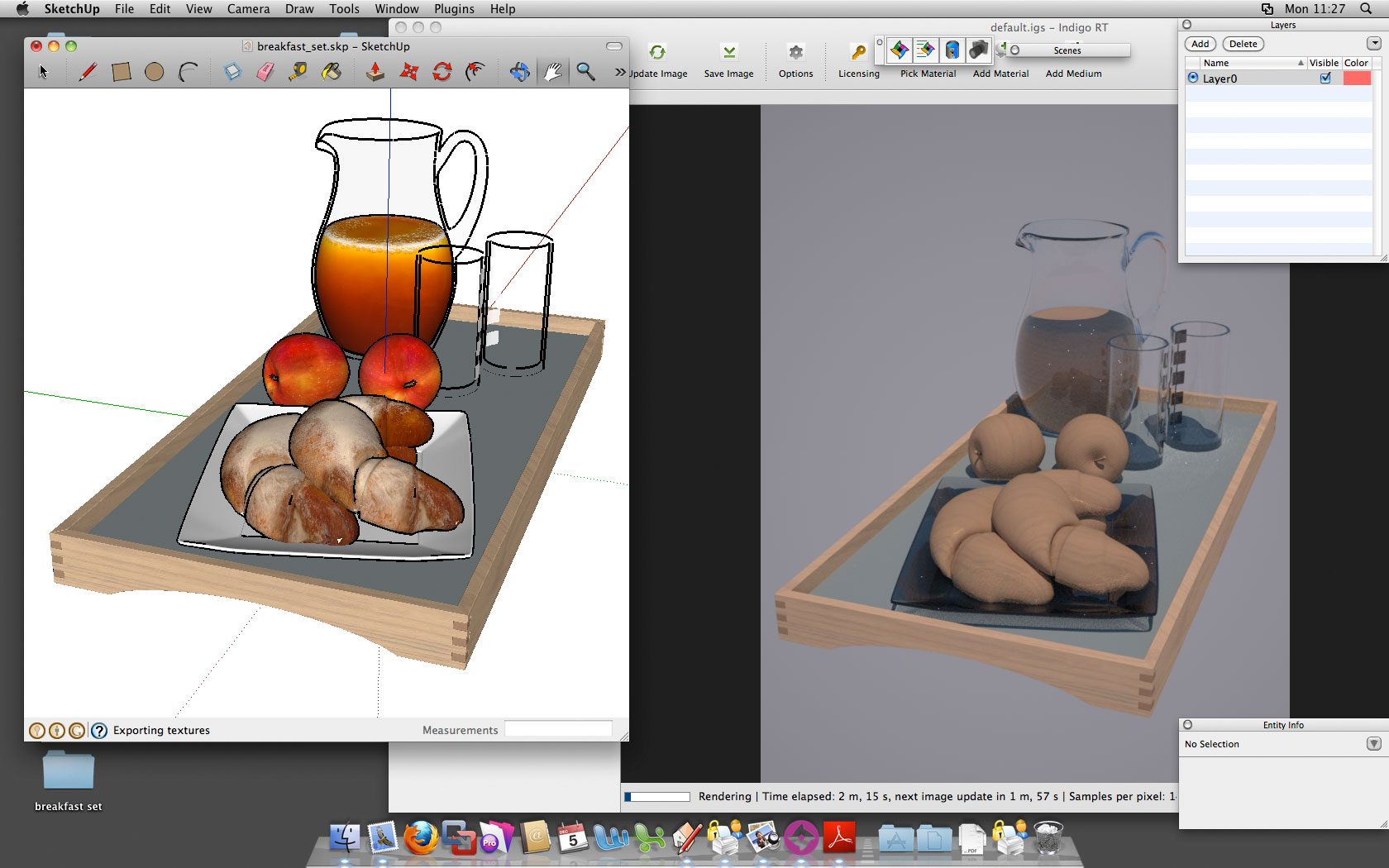

Thanks Snorky,
That solved the textures problem... It was a bit strange as the wood texture had also a long name but it did pass without problems...
anyway. see attached JPG to see how it looks now.
there is still two problems, one is the plate texture. which in SketchUp is just a flat color with 95% opacity.
the other problem is these infamous white pixels... that the longer the render runs the more thwy apear all over the glass... I will let the render run for longer but I don't see any of them disapearing with time.
Any help will be apreciated.
Re: SketchUp textures problem
go slowly!!!!adrianbonet wrote:Thanks Snorky,
not so strange... wood texture is only one exported and applied to all models with diffuse material
plate, glass and all texture/material must be correctly set!!!
please read this on Indigo manual to set material correctly.
"infamous white pixel" disappear for:
- more calculation time
- best material setting
- best light setting (here)
sorry for my bad english...

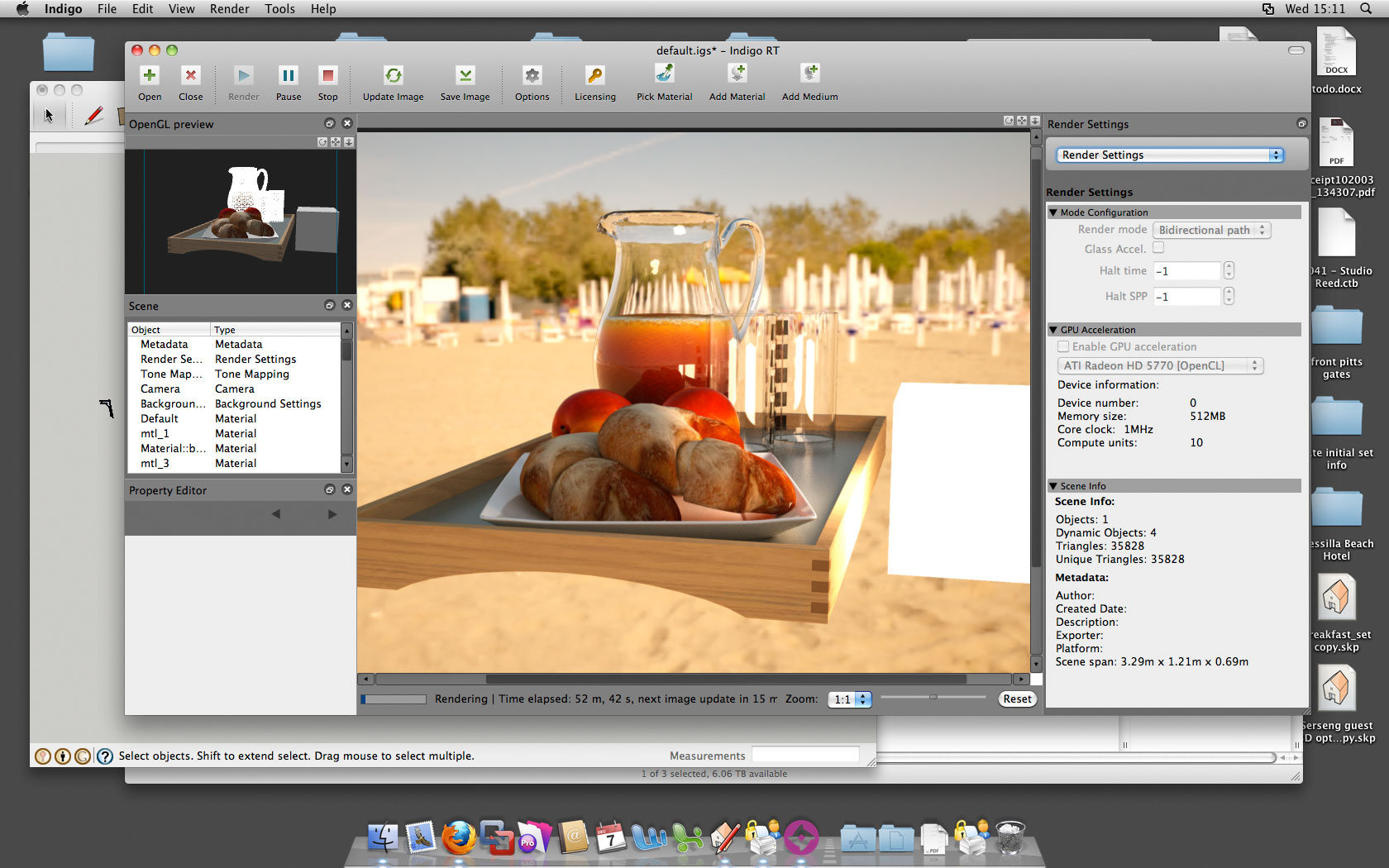

Well having a background image makes the white dots disapear...
let me fix now materials and lighting...

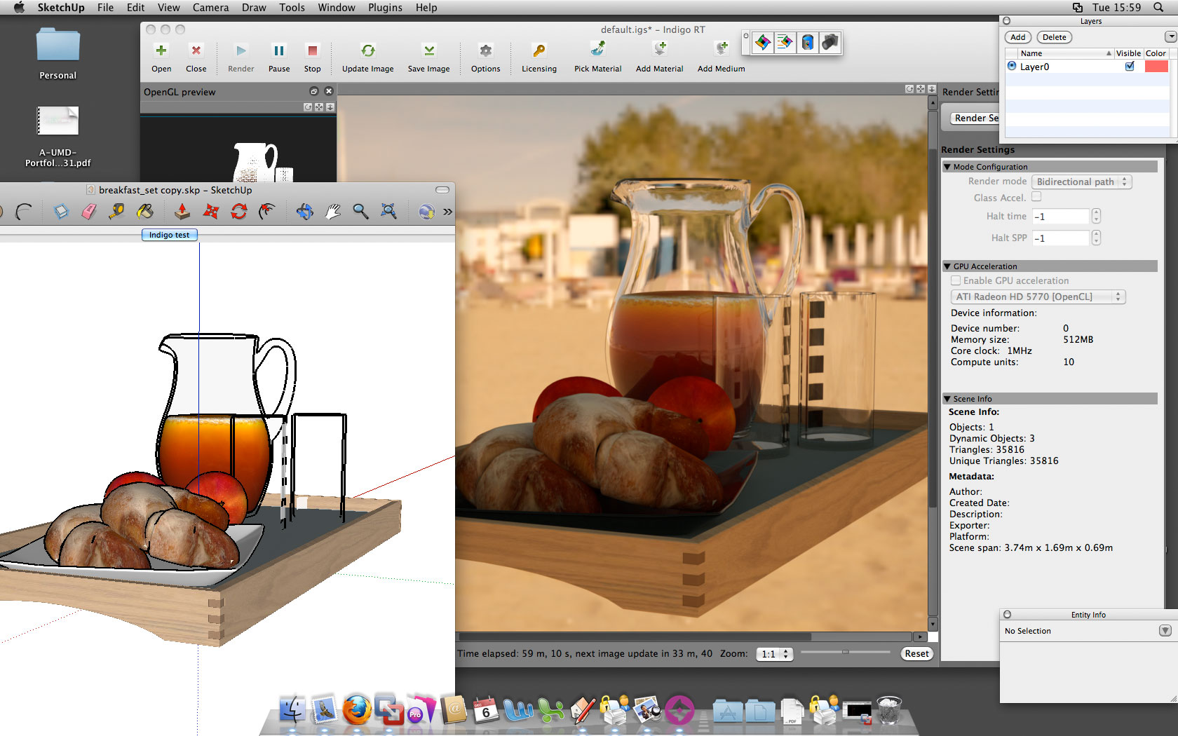

So far the white dots appear only when using the standard sky and atmosphere setting from SketchUp/Skindigo
here it is the latest image. with some ceramic for the plate as well as some shyness for the apples and grey bottom.
now the problem was that the Environment map illumination is to even and soft. it makes the tray looks as if in were in shadow. with no hard shadows anywhere. what would be the best way to achieve a shinier look? and sharper shadows? but still keep the environment map?
I was thinking about putting a fake sun some meters away. in order to have some better shadows and overcome the shadowy lighting that I had before. But I am not able to get a light bright enough... is this idea possible?
I wouldn't use a lightsource to simulate the sun, personally.. Too difficult to set IMHO.
I'd rather lower the gamma of the EXR: that will result in sharpened shadows.
IMHO= In MY Humile Opinion
gamma of the exr: just open your env map (EXR) in photoshop, go to IMAGE->ADJUSTMENTS->EXPOSURE, and move the gamma cursor to the left.
..and I am not a pro: only a student like you.
There are loads of people much more professional than me, here in the forum!! BTW, thanks: I take it as a compliment
