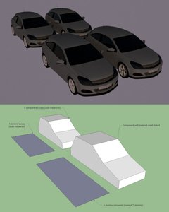

Hi, Since I used the new version, everything goes fine. but when am trying to using dummy to replace the trees like the old version. I can not find that instance option in the right click menu. Is there anybody can help me?

In the latest skindigo, the instancing function has been automated.
Whenever skindigo finds two or more identical groups or components it automatically converts them into instances. That's it...
Plain instancing only works inside Indigo, and is triggered during the export process. using simple instancing will not make your sketchup scene less heavy.
But you can work with external meshes, OR with dummies. The concept beneath the procedure is that you can subsitute a complex component with a much simpler one, and still get the complex model to be rendered after the export. It's like working with external meshes, but you have all your components inside the Su model.
Say, for example, you have a huge restaurant room with hundreds of chairs (component named "chair"): you have one inside Su, but multiplied by 300 times it makes the model too heavy. You can model a simple cube, call it "chair_dummy" and it should work.

Yes, using the '_dummy' naming convention should still work in 3.0.15 but the instancing part of it should now work automatically.
