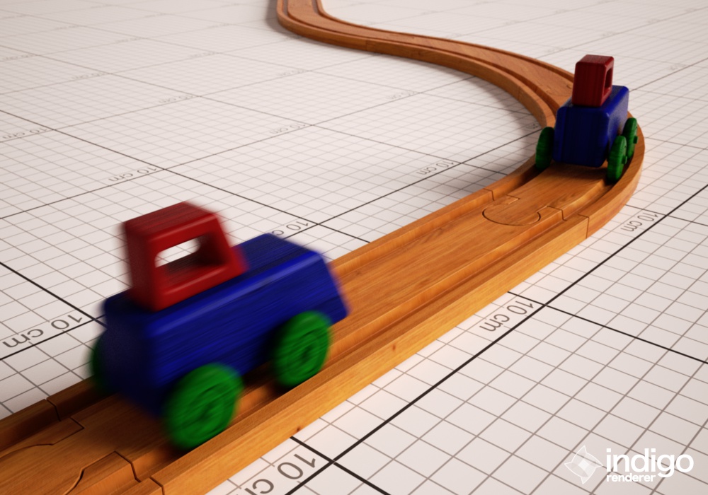

Blur Test

I think there should not be a blurred area in front of the train because it hasn't been there?
Re: How to Use Motion Blur
Post by CTZn » Sat Mar 03, 2012 7:34 am
it is exactly there at the end of the frame :)
On average the e:occlusion of the background by the vehicle is centered over the whole shot, but during the time of exposure the object is effectively travelling from one point to the other.
Having blur only at the back end is an artifact coming from comics !

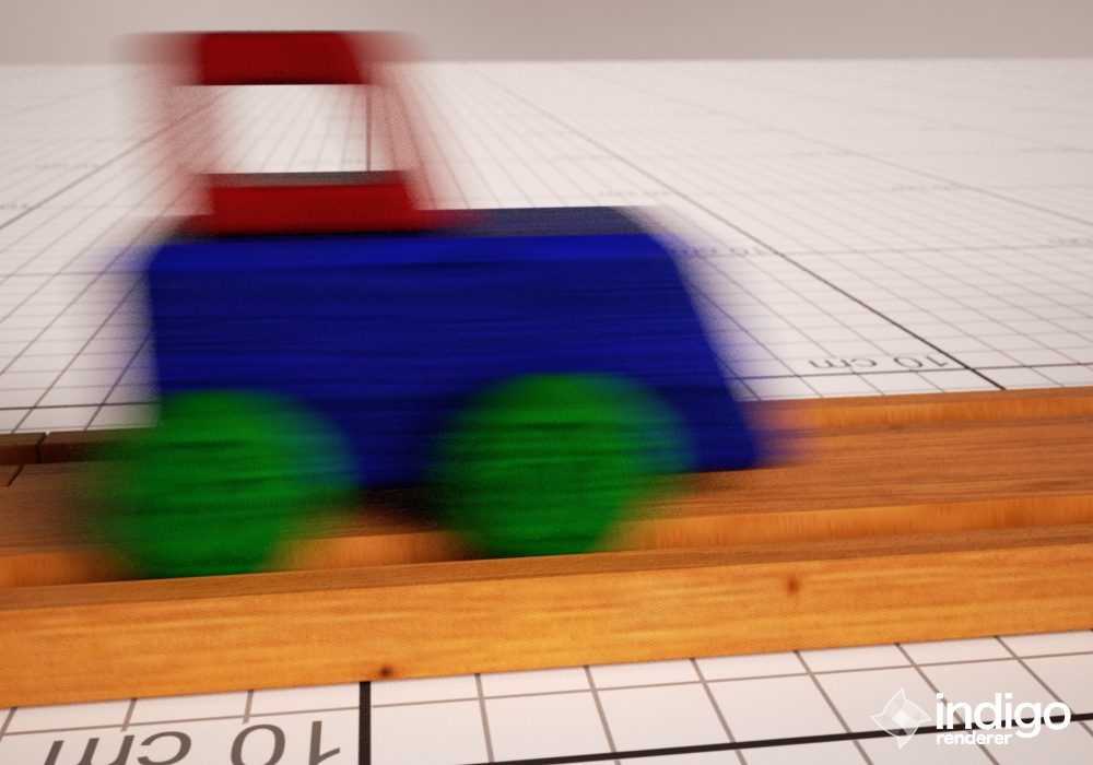

cotty
Posts: 314
Post by cotty » Sat Mar 03, 2012 8:05 am
CTZn wrote:it is exactly there at the end of the frame :)
Then I have no bad conscience, to show another example... :roll:

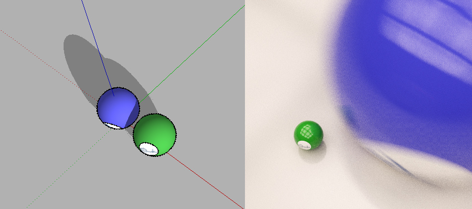

Post by cotty » Fri Aug 17, 2012 2:05 am
I have noticed the error described here again and because there is no manual instancing anymore, I am not able to get the right result. Any suggestions?
(I only moved the blue sphere along the red axis without rotation)
Whaat
Posts: 1827
Location: Canada
Post by Whaat » Fri Aug 17, 2012 7:37 am
cotty wrote:I have noticed the error described here again and because there is no manual instancing anymore, I am not able to get the right result. Any suggestions?
Hi cotty,
Make sure there are no nested groups or components inside the object that you are applying the motion blur to.
cotty
Posts: 314
Post by cotty » Fri Aug 17, 2012 8:05 am
Whaat wrote: Hi cotty,
I think I have followed all the steps from the first post and the spheres are without subgroups...
I have attached the file for testing...
