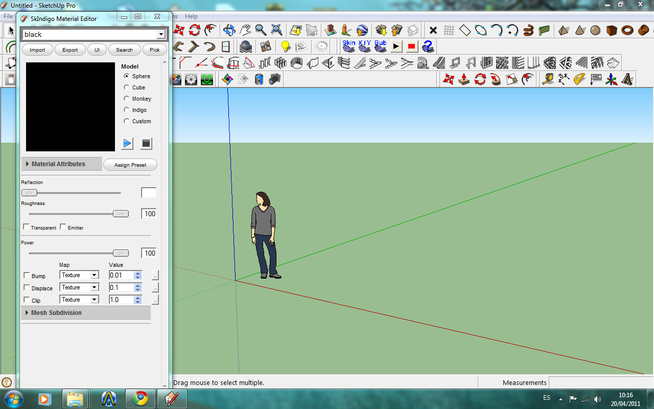

sorry for my english...i cant power up a light over 100... here its a pic for you tu understand what i mean..
light power doesnt go further than 100.

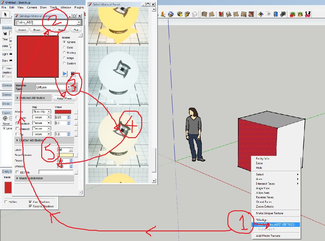

You're not actually editing a light there, you're still in 'material attributes' - you need to click the UI button at the top of that Skindigo material editor box (next to import & export) and an additional menu appears below called 'emitter attributes'. Expand this and you can then set your light layers power, efficacy, colour etc, and also ies profiles if required.
Essentially, this is where you edit everything to do with your lights (emitters).
Easiest way to create a light/emitter with indigo/sketchup is to create a new material in sketchup, then once applied to your model, right click it and select 'edit material name' under the Skindigo heading. The material editor opens up and you can then either set up lights using the settings as above, or just click 'assign preset' and scroll down the materials list that appears until you reach some common lights at the bottom.
Hope that helps.
