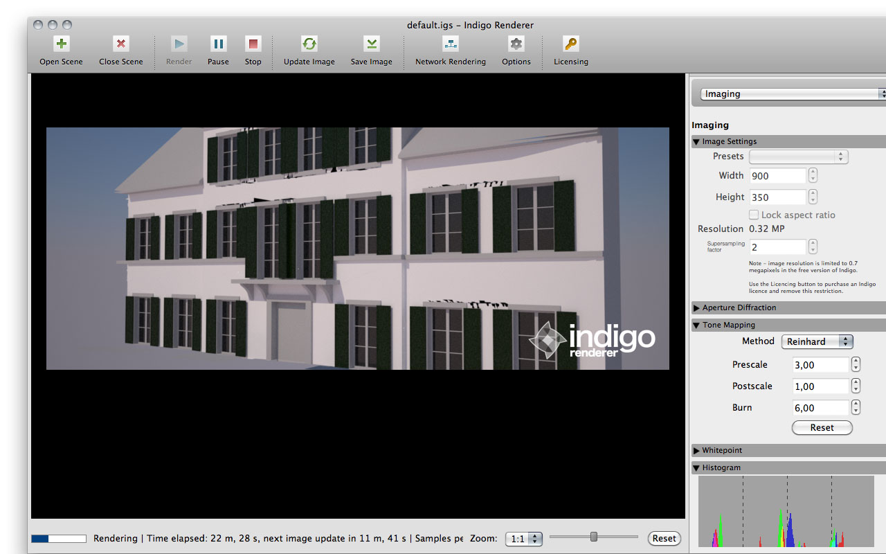

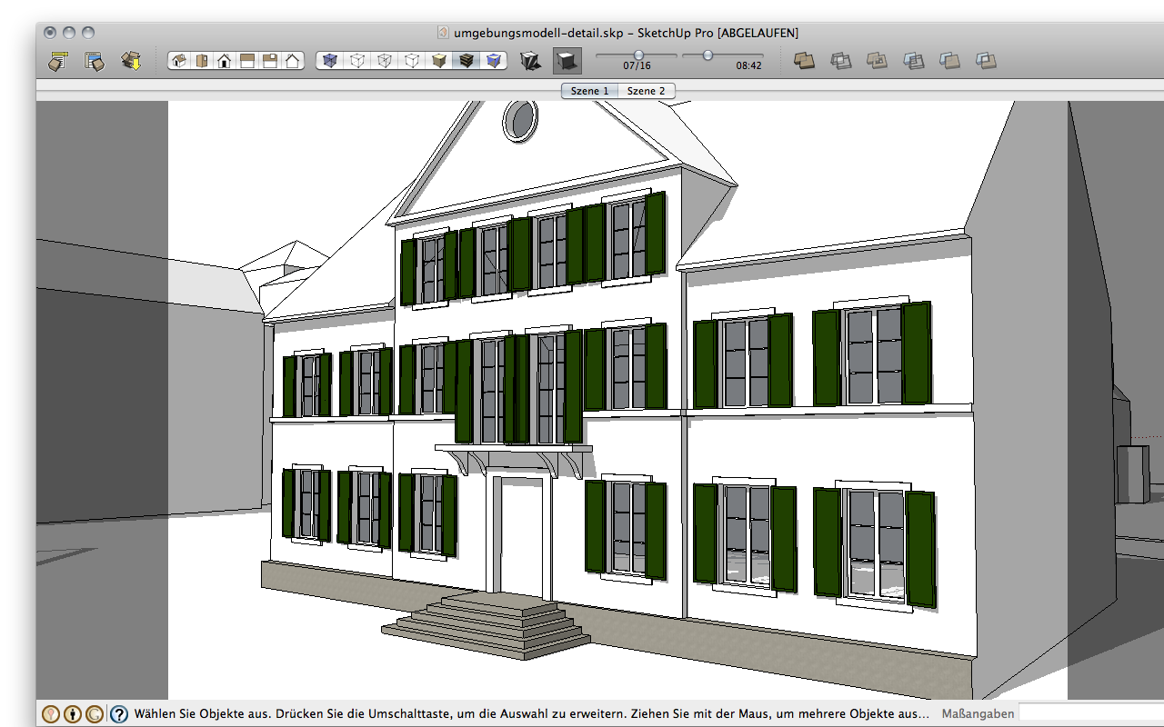

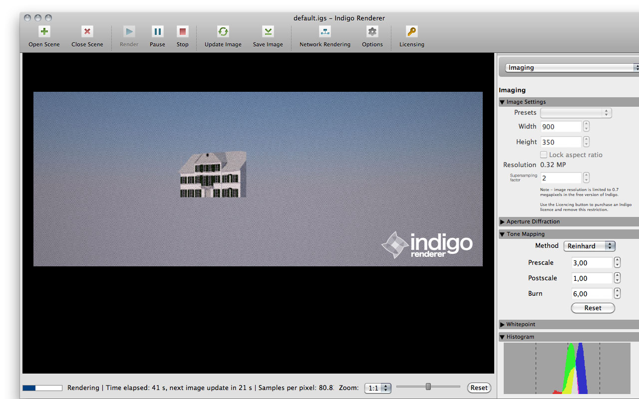

hi. i just started to put some materials on a sketchup model i did yesterday. by rendering it for tests i got some unexpected results.
what might have happened? sketchup problem or skindigo mistake or indigo error or my own guilt?
thanks i advance for any help i get!

1.only a part of Your model is being renderer - > when some object is selectend during export skindigo asks about rendering all scene or selected items only. Before export, make sure that no object is selected or click 'no' when prompted

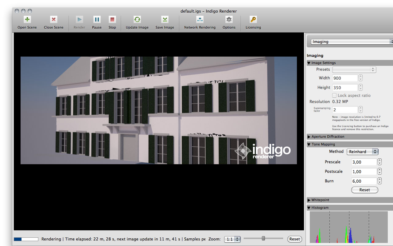

2.there are wierd black areas on Your render -> back sides of surfaces may not render propely. Make sure that all visible surfaces are directed front side to camera (in other words check normals). Also make sure that Your surfaces don't overlap - this may cause errors

Hi. thanks for the answers. but i'm still stuck.
i'm quite familiar with the "rules" of indigo. so my faces are oriented in the correct direction, no surfaces are overlapping in this model (never had problems with overlapping surfaces in earlier models). nothing was selected before exporting, of course!

You need to define exactly which part of the results you think are 'unexpected'. Is it that part of the scene appears to be missing? The black triangles? Something else?
Re: parts of model disappear when rendering

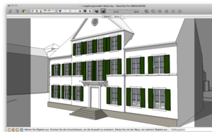

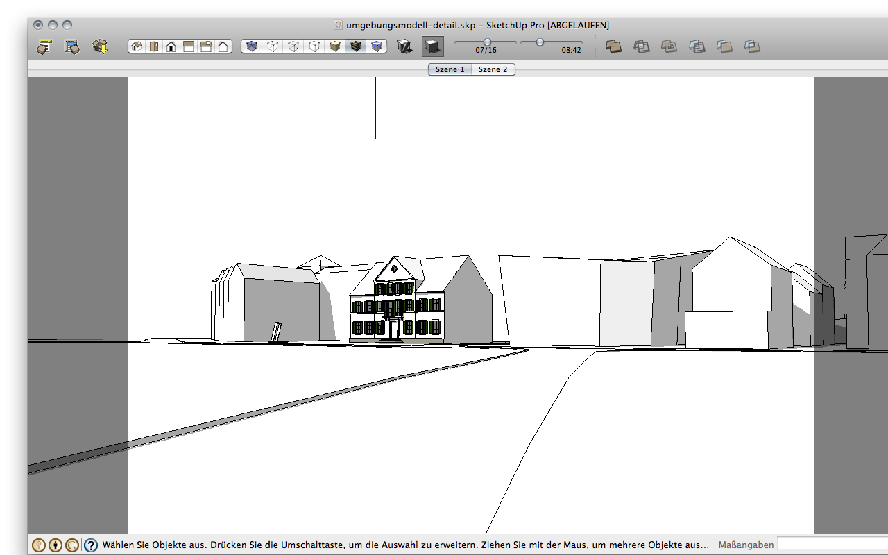

well i thought this was obvious. thats why there are screenshots of the sketchup model as well. everything in the sketchup model is supposed to be seen. and nothing is supposed to have black stains.
btw i tried rendering the modell with the sketchup standard material only. the result was without stains and everything visible. in the model that has errors i only used sketchup and indigo-website materials.
what might have went wrong?

Someone using blender just reported a similar issue with Indigo 2.6.1, that's something I didn't see for long. Here's my answer, doesn't mean it's relevant though (a bit more if you replace "blendigo" with "SkIndigo"):
Hope that helps.Indigo has two methods to build geometries in memory, the setting might be in the advanced options of blendigo if present. It is a threshold in poly count; if an object has less triangles than that it uses one method, more it will use the other.
One of the method may be faulty but you can force the other by setting an extreme threshold value. Try with zero and if it's not better try a very big number, like 10000000.
The mentionned tag name in the igs is <bih_tri_threshold>.

In your message above you stated that when rendered with the Sketchup material only the render was fin but problems started when you replaced some of the Sketchup materials with MAterials from the Indigo Material Database. Did I interpret that correctly ?
The reason for the strange results may well be one or more of the Indigo Database materials so I woud suggest you remove those one by one and see how that impacts your render results.
I think that not all of the materials in the matDB are necessarily useable with the newer Indigo releases.

Could be a layers issue. I think SkIndigo has an issue when faces are inside groups and not on layer 0. Make sure that all your faces are on layer 0. Groups and components can be on any layer.
