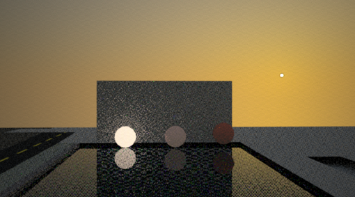

I met the same problem before, I know that recently, and the way is ----lager power. I do a tast for you.[img
The right one's power is 10000! and it bearly has light, the middle one is 20000, the left is 100000, now you can see how much power you need ?
