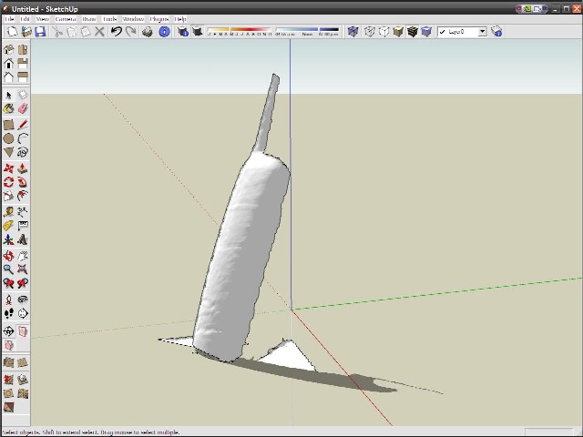

I tried the importer with free sketchup on various obj files from various sources and it works using the mesh option (although its definitely v. slow on large models) however for some meshes there are a number of holes in the result...in some cases a great number.
when I try to create a face it tells me they are not planar..I guess there is a difference in precision between applications. :?
the other import option seems to hang or perhaps it is just extraordinarily slow? so far using vrml and blender is getting better results for me.
see attach for a successful import of a rough laser scan of my phone I made using DAVID laserscanner. this took 5 mins to open and was 37,000 faces...:roll: but some of my stuff like the motorbike has over 500,000 and one or two have been1.5 million so dunno...
the SW obj exporter would not work for me. I tried making a button for it as well but same..unless I am doing something completely wrong...
obj import.JPG (44.11 KiB) Viewed 27999 times
