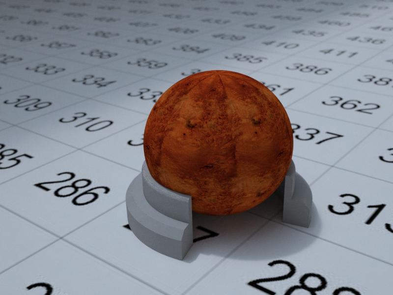

Here's my latest test image.

To get the textured materials I have the attached files copied into the materials folder, which is in the macro's folder.
As can be seen in the first image the floor and sphere have materials assigned to them, when they are created, with the same names as the material files put into the macro's material folder.
Any part that doesn't have a material assigned looks at the colour info which was set by right clicking on the part name (second image) and selecting appearance and changing the colour. (Material files are standard Indigo materials definitions in separate files. You can make any material file and then create a material by editing materials available in solidworks.
I have already managed to get the texture info also and just have to implement it along with the other settings such as specularity, shininess etc. for the colours.
