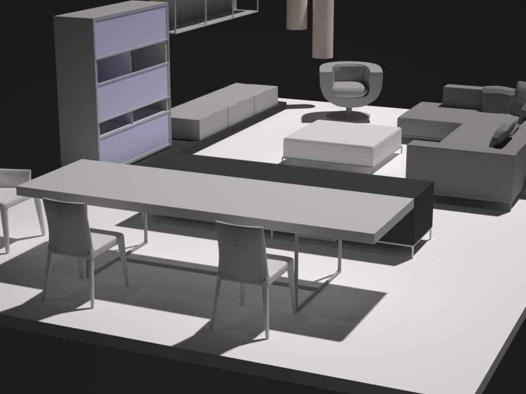

I'm writing an exporter for my CAD Application to Indigo Render.
Currently I'm only using B&W (more or less) diffure material but I want to use textures (see my test image and see original scene http://www.youtube.com/watch?v=p3EzCgTEwRU).
In my Application texture attributes (gain and offset) are related to materials and not to objects. Each object has its UV set but is the union of Material UV attributes + Object UV coords that defines the final mapping of a texture onto surfaces/objects.
Is there something similar into Indigo scene language ? Can I use the tag <u_scale> (or <v_scale>) inside the tag <albedo_texture>?
Regards
Delle

Hi Delle,
there are no <u_scale> or <v_scale> parameter inside any tag referring to texture in indigo scene description. Inside the <albedo_texture> tag, for example, the only reference to UV values is the <uv_set>. Adjusting the UV values exported during the mesh creation process you can properly "scale", "move" or "rotate" your UV coords.
Hope this helps, R.

Hi R. Gigante, I know that I can use uv_set during mesh creation process but, in my case, I prefer to change materials/texture mapping into igs file directly without re-export all (I'm currently testing Indigo materials).
In addition to this, I use many textures with different mappings for the same material. This force me to create many uv-sets for all objetcs.
....maybe adding a little gain/offset feature to Textures could help :D
Delle
