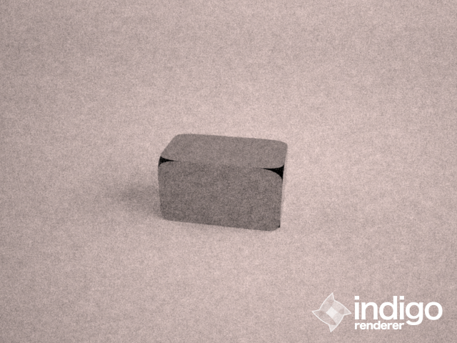

In some/many cases that subdivision doesn't work. Maybe it is bug?
For example create cube, with number of subdivisions for height, depth and width.
Hit 3 and activate subdivisions in Indigo editor (just as on pic u attached). You'll see that there are strange stuff happening in render. Can you confirm that?

Apparently the setting MtI uses for subdivisions only works if all your edges are soft.

For subdiv you need to control "normal smoothing" (or however it is called in Maya)!
for maximum normal smoothing so subdiv don't "detach" parts of the mesh.
best to test with a cube! absolute normal smoothing + subdiv = cube becomes a sphere
to low normal smoothing + subdiv. = 6 planes get detached

Exactly, I get 6 subdivided detached planes. It is happening when 'smooth mesh' is checked. When it is not checked, there is no subdivision happening ...

Edge smoothness, correct. Faces will merge together in Indigo only if shared vertices also share their normals. In short hard edges can't merge together. Use bevel to control the final shape.
