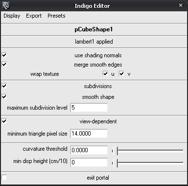

What is best way to manage meshes that are viewport smoothed (by hitting 3)? In render they are not subdivided at all.
Re: MtI 2.x beta 2
Post by CTZn » Sun Nov 07, 2010 3:40 am
SreckoM wrote:What is best way to manage meshes that are viewport smoothed (by hitting 3)? In render they are not subdivided at all.
Smooth Mesh is a display feature wich Maya Software does not use for rendering. Wouldn't it be confusing since Maya has proper mesh subdivision parameters already ?
Mixing these parameters together would only make Indigo subdivisions more complex to set. Also it may be convenient to activate subdivisions this way for small meshes, but forcing users to actually smooth the displayed meshes to enable subdivisions during rendering is counter-productive on most scenes.
Smoothing the mesh display further after displacement/subdivisions is not an option in Indigo. Smooth Mesh behaviour is inconsistent between renderers, I can't find in their Render Globals the switch wich disables it during rendering in HW and mr.
I'd rather keep Mesh Smooth aside as a display only feature, but that's not because MtI is still limited that I want to keep it so. Your suggestions are welcome.

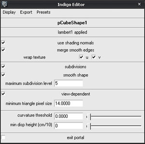

SreckoM wrote:I am talking about subdivided meshes, it is more precise term than smooth. Hitting 3 on keyboard your meshes are subdvided, but you can go back by hitting 1.
I tend to agree that having only subdivided meshes on display with a complex scene would be hard to deal with. The indigo-subdivisions CTZn is talking about are located in the Indigo Editor. I haven't played a lot with it yet, but it gives about the same result as if you had a subdivided mesh with the "3" key.
