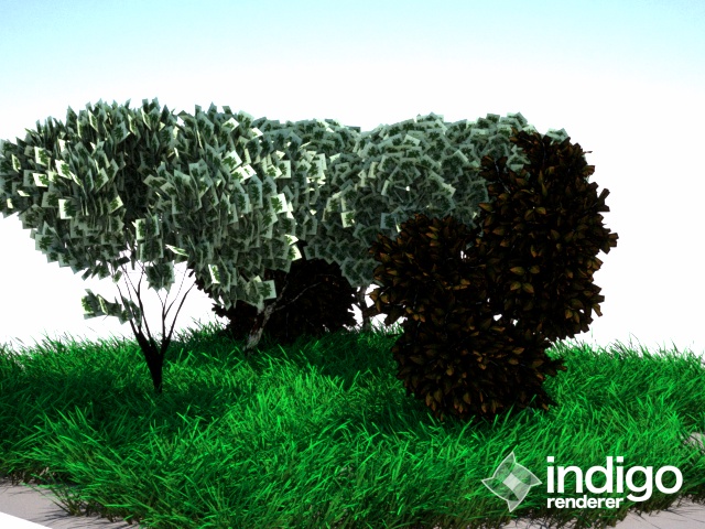

Re: [NEW VERSIONING] MayaToIndigo JAN-2010
just the test render, pfx:
grass is made of half a dozen instances, tress about one quarter each.
Raw materials apart one ramp shader converted to a phong, no fancy stuff.
Nice! Did you say it will support paintfx?? that'd be great if it's possible, but I know even mental ray that comes with Maya cannot.
Hey $oup, paintFX is supported since brushes can be converted to meshes, just as for mr
Some default materials must be changed to supported ones tho, like the rampShader.
