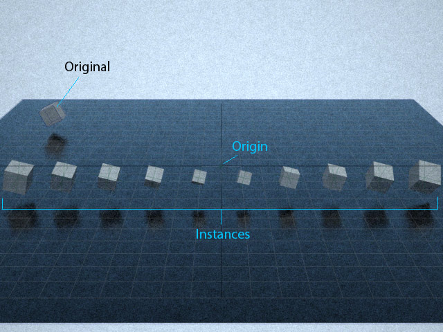

Post by dougal2 » Sun Nov 25, 2007 3:26 am
The issue requiring the instances object to be at the origin for it to work properly.
The issue of having rot=pos=<<0 0 0>> in the model and translation/rotation data in the obj itself. We're not really using <model> correctly.

Indigo render overlayed with Maya viewport + text

Could do, but I found a better solution... it's possible to find the World location of a child object without unparenting it.
REV 148
Fix for exporting correct location/rotations of parented objects.
Fixed cd command in RenderDirect.
Re-enabled IESLocator.. NB, do not duplicate IESLocators, get errors about duplicate mesh names.
Each sphere is a child of the sphere to the left. Same with the instance locators.
dougal2
