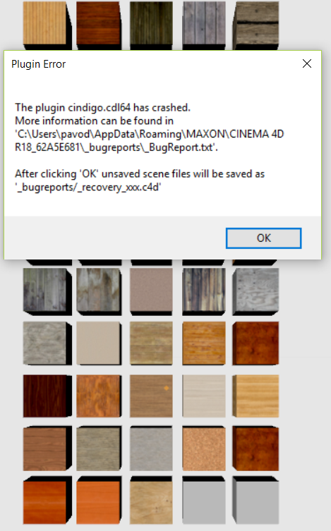

Hi,
If I put more then about 40 materials with textures in to the C4D scene, cinema crash after hit render... everytime. :(

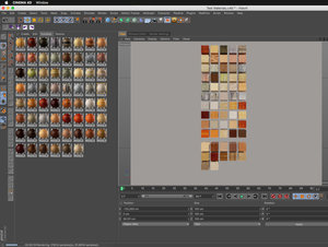

:shock: i will test this on Mac.
Can you upload the file?
Update: Seems to work fine here.

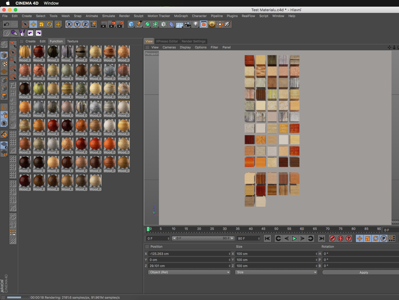

Post by pavoda » Mon May 01, 2017 11:06 pm
If I dissable all textures but number of materials remais the same, render work OK.
Your materials look like than contains a few textures...number of all used textures in materials is probably key parametr.
Try my attached scene please.
Test Materials.zip
(3.09 MiB) Downloaded 593 times
Originalplan®
Posts: 757
Re: Cinema render crash
Post by Originalplan® » Mon May 01, 2017 11:27 pm
Tried your scene pavoda.
It renders fine by me on mac. BiDir & GPU too.
No crash.
