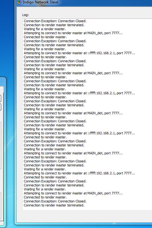

Post by det1971_ » Fri Apr 15, 2016 2:59 am
this is what i get... out of indigo slave
Re: TEAMRENDER in C4D and SLAVE do not work in indigo
Post by lycium » Fri Apr 15, 2016 3:58 am
Some quick checklist items:
Are both master and slave running the same Indigo versions? I recommend the latest Indigo 3.8.31 version.
Has the Windows firewall exception successfully been made on both master and slave computers?
Indigo doesn't actually support the C4D TeamRender feature, it has its own network rendering.
Regarding the last point, I think we could isolate the problem if you quickly run through the network rendering tutorial, and let us know at which step it fails: http://www.indigorenderer.com/documenta ... g-tutorial
